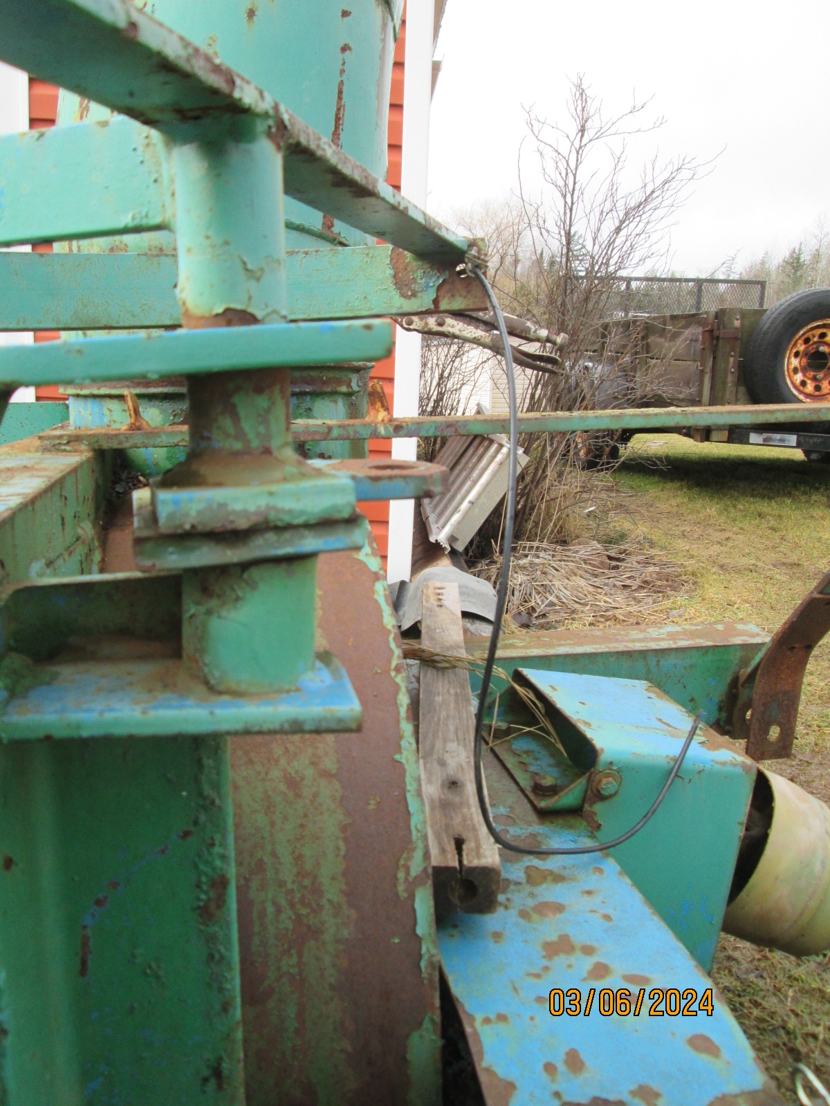

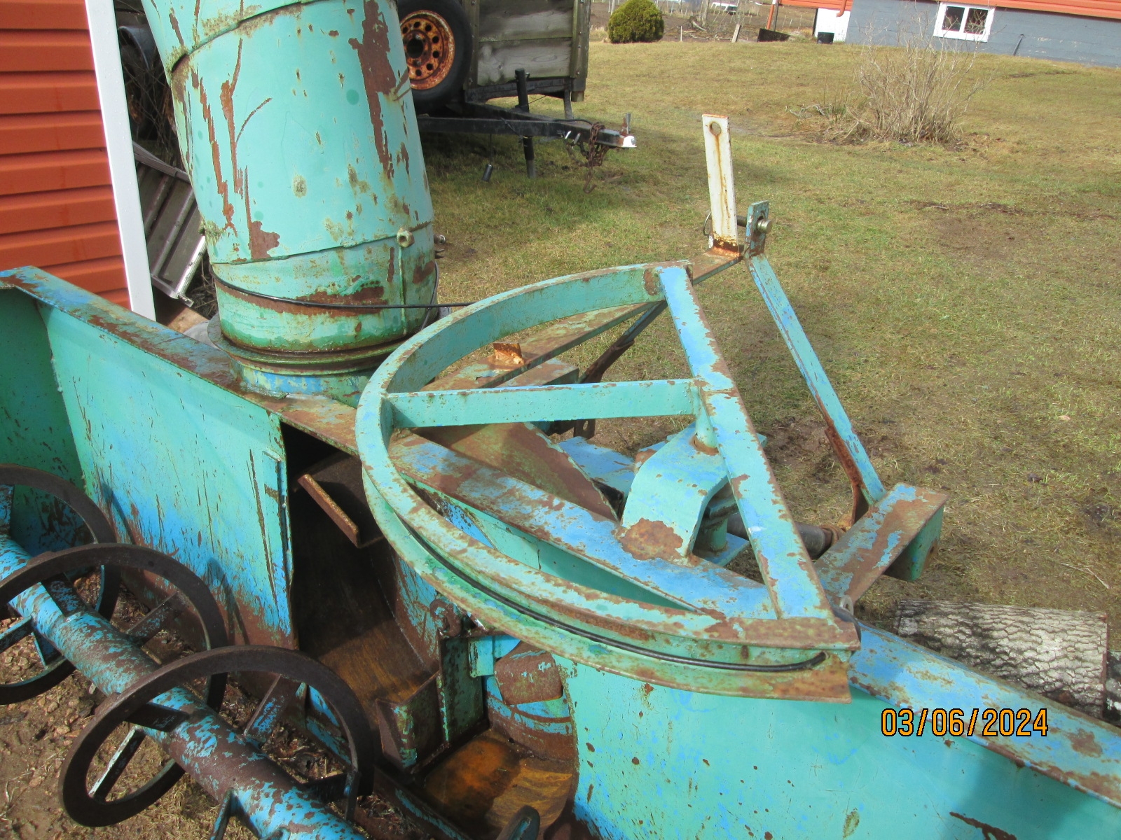

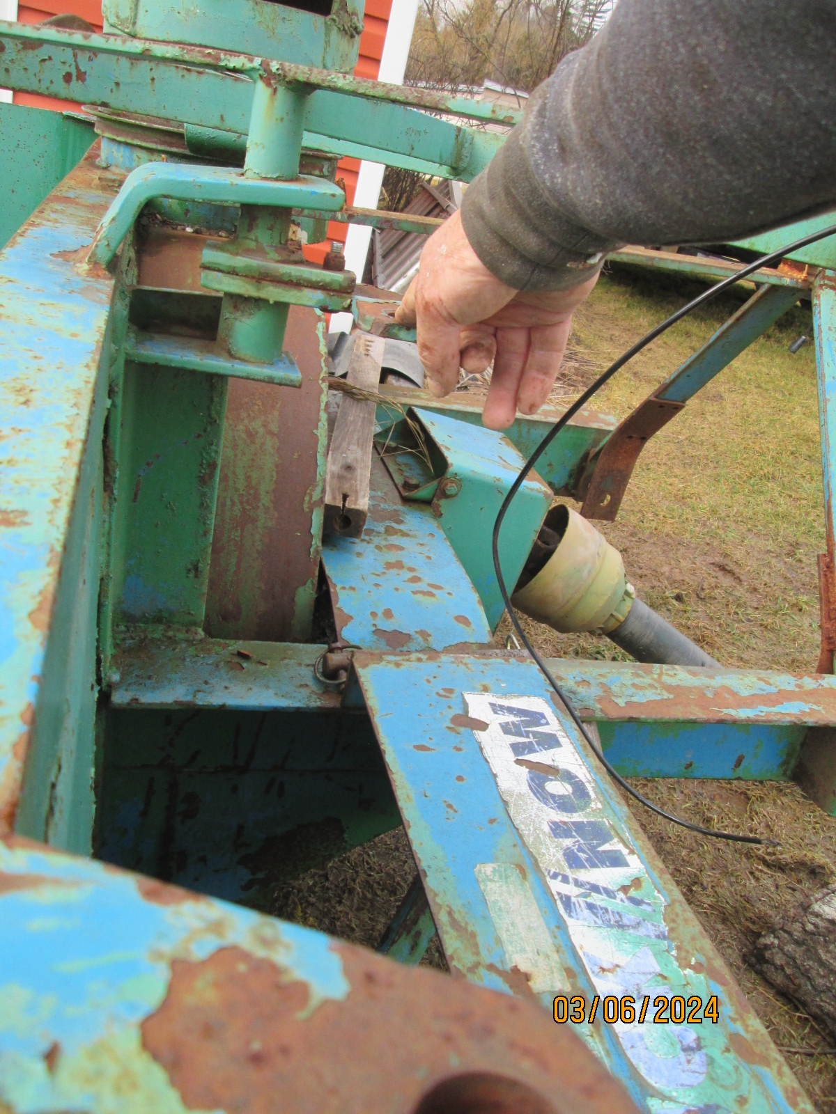

Have a Lucknow 6ft snowblower . When I bought it used 7 years ago it without the shoot direction cylinder as I didn't have rear remotes . I welded up a manual hand crank to move shoot since then. Now a tractor later I have remotes and looking for a cylinder . . I need to cut off the hand crank I added but how do I figure out the proper length of the the new cylinder?
   / Luck now snowblower shoot cylinder question. #2
Fabricate and mark the mounting points. Swing the shoot to both stops left and right. Measure the min and max cylinder length needed.
All the mounting points are there. Seems I need a 21.5" short and 28.5 long". 3x8 bore ( found some info online) . But the ones I see not the right distance for open and closed. Guessing short is better then too long as how its built will bent the ram on the cylinder.
   / Luck now snowblower shoot cylinder question. #4
Does you Luck Now blower use the half moon shaped cable setup to rotate the chute?

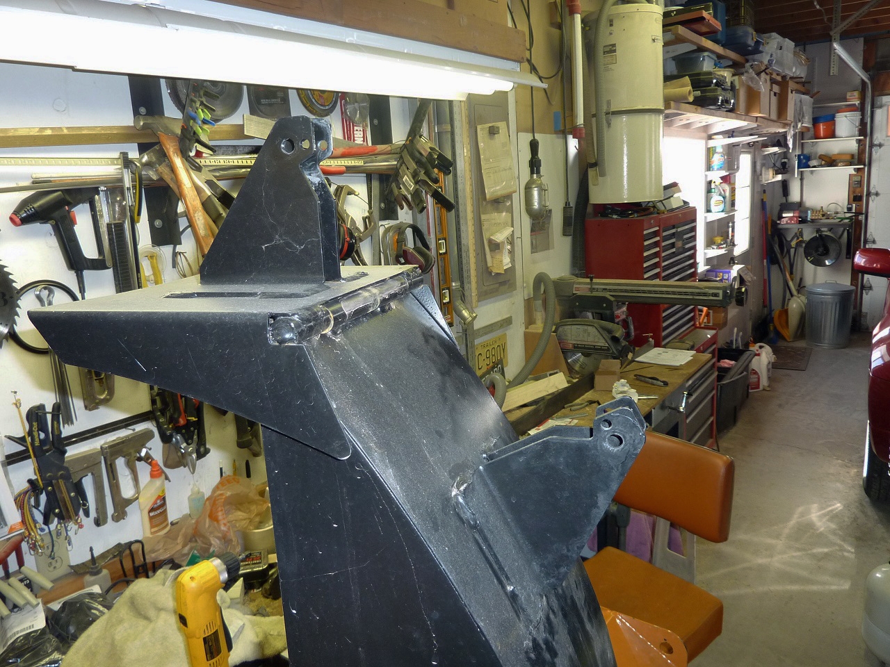

A few years back, I posted a thread on adding hydraulics to a Woods SS74 blower.
I cut off the chute deflector mounting ears by grinding off the welds. I then used the cylinder to locate the new mounting position:
You may be able to use the same idea with the rotator.
I used a hydraulic motor attached to the crank shaft to turn the chute. You can see the whole project here, which may also be of some help:
