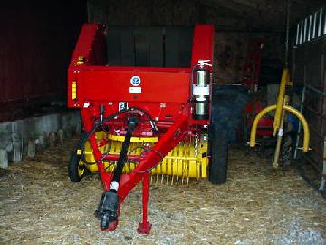

ledebuhr1:
When I ordered the blower, this fall, I requested it to be painted orange. I would have taken even an Allis orange or a Massey orange.
New Holland blue is a little hard to swallow. I have a NH bailer. It's red.
