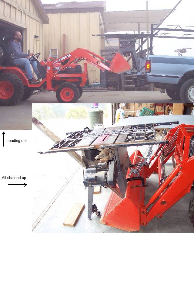

A friend needed to borrow my table saw over the weekend. That's fine, but how do I load a 200# table saw in the back of my truck without a helper?
Lucy! to the rescue!
Attached photo shows how I overcame the problem of Lucy!'s bucket only having room for two of the table legs. A little creative chain work so that I could cantilever the saw out in front of the bucket. I used a couple of 6" clamps to secure the close legs to the top of the bucket, and a couple of smaller clamps to attach a chain (also to the top of the bucket). The chains ran ove the top of the saw to a 2x4 that was jammed into the back of the bucket (for leverage).
Above that, is a little staged pic showing me loading the saw into the truck.

Where there's a will, there's a way./w3tcompact/icons/wink.gif Nice pictures.

Just pick it up and huck it in there. Sissy.
(Hmmmm... that sounded funny in my head -- hope you read it that way. /w3tcompact/icons/crazy.gif)
Seriously, even with Lucy! and her loader, there's a lot of ways to approach that task. The one you've pictured here looks dandy to me.
How do you feel about someone named Lucy! having bigger biceps than you? /w3tcompact/icons/laugh.gif
Nice picts.

I guess I deserve that after my comments on snakes. /w3tcompact/icons/laugh.gif
Darned snakes wouldn't help me either.... /w3tcompact/icons/laugh.gif
If I had those clamp-on forks, it would have been a lot easier.
