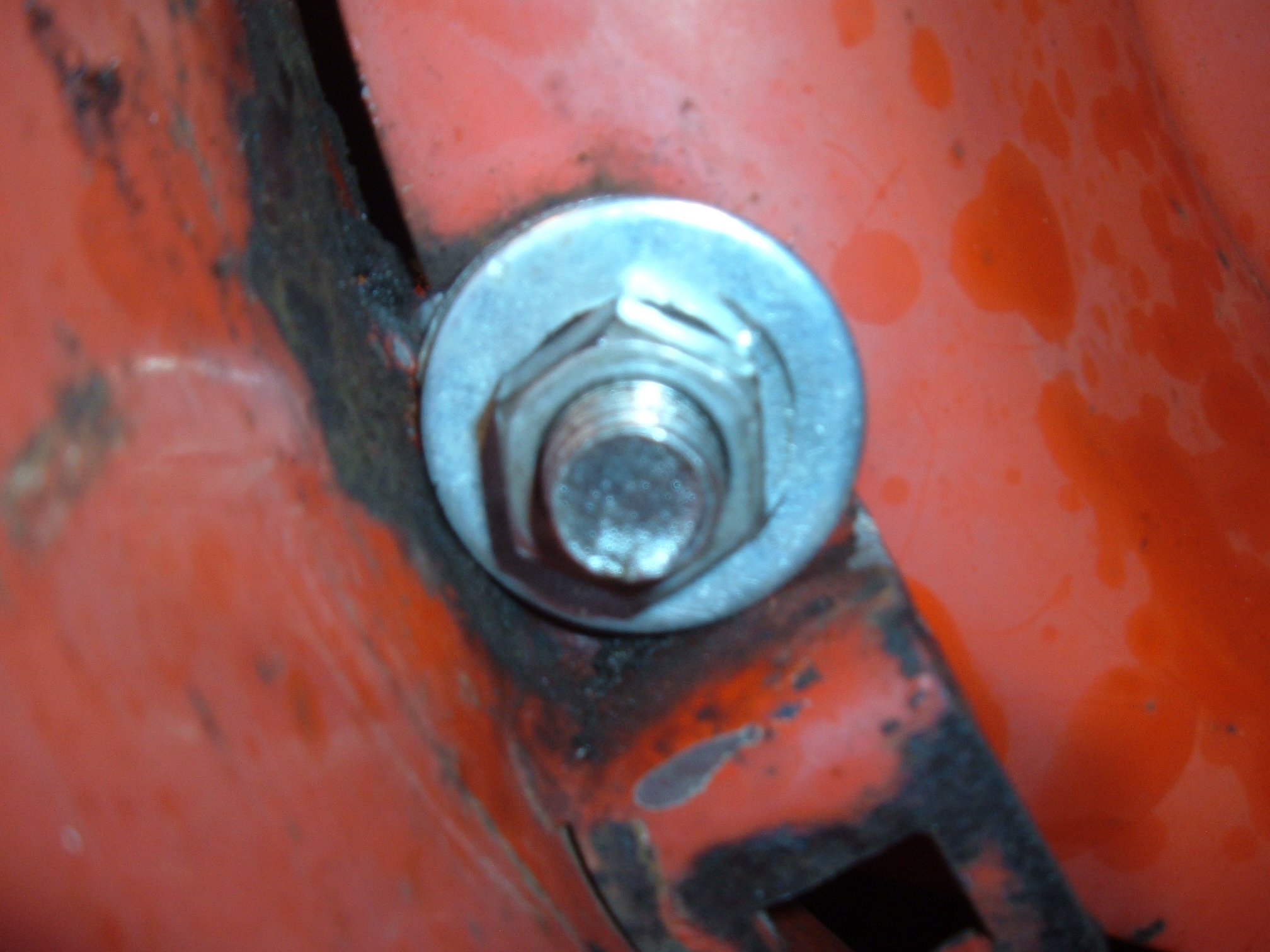

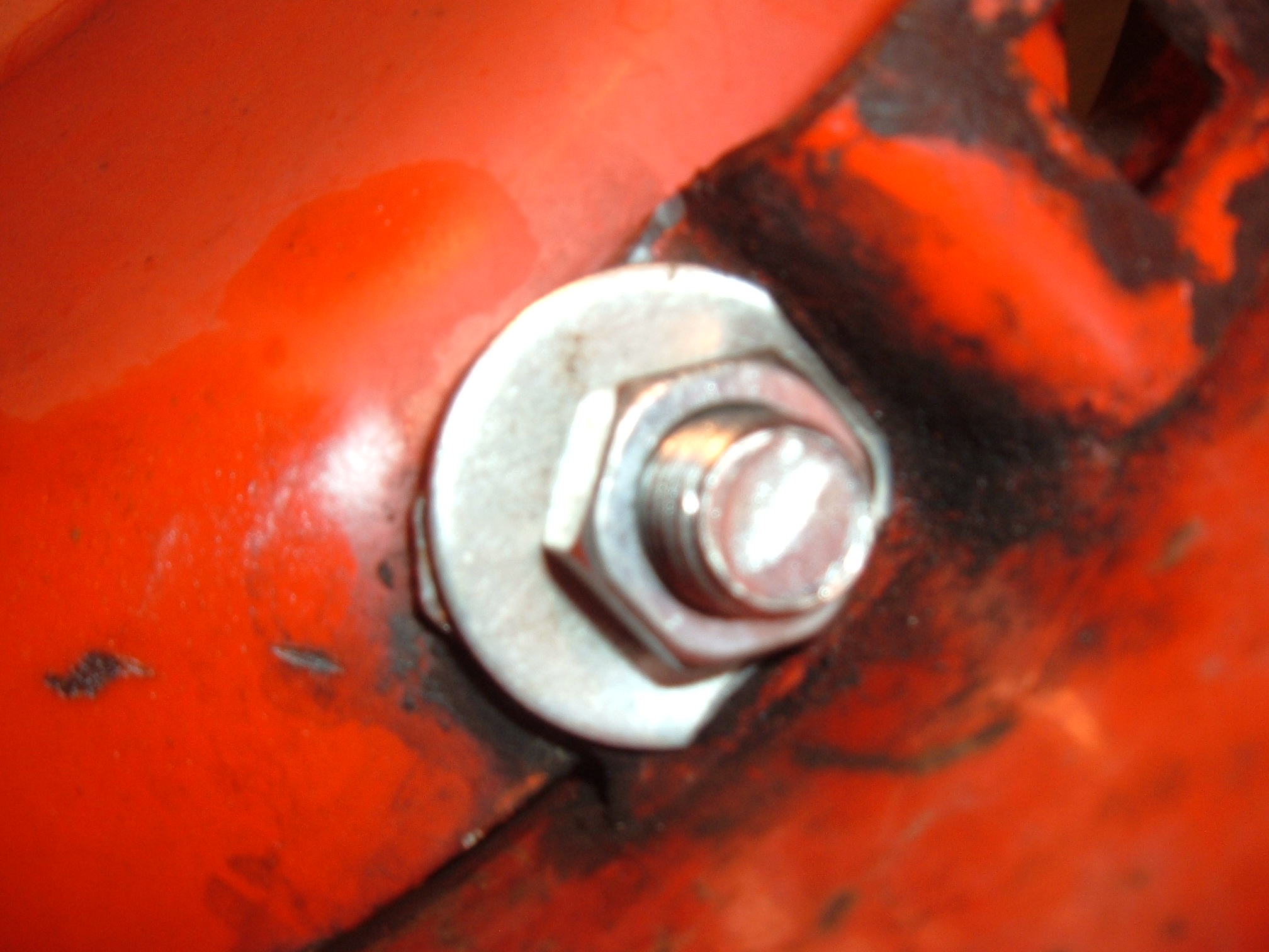

Mine loosened up too. I also run chains with studs (like the Aqualine Talons). I solved the problem by replacing the bolts with longer ones and put nuts on the inside of the hub. I don't think this could be done on the front wheels but on the rears there's plenty of room. I think the problem is the chains get too much traction and when you go from forward to reverse kind of quickly (or vice versa) the wheel slips slightly. The holes on the wheel are slightly bigger than the bolts so there's a small amount they could move. The only thing stopping it is the friction from the bolt clamping the wheel to the hub. Once the wheel moves slightly it creates just a bit of wear. The wheel on hub is paint on powder coat. As it wears the bolts sooner or later loosen up.

This was a rear repair where bolts came loose and wore holes out. Simply stacked a couple flats. First thought we were gonna make them, then the brainstorm said cut the edged to fit in the corner of the lugs then we figure out they actually fit better and align it whole. We doubled them and lube the bolts with a little spray and drive them tight with impact.
