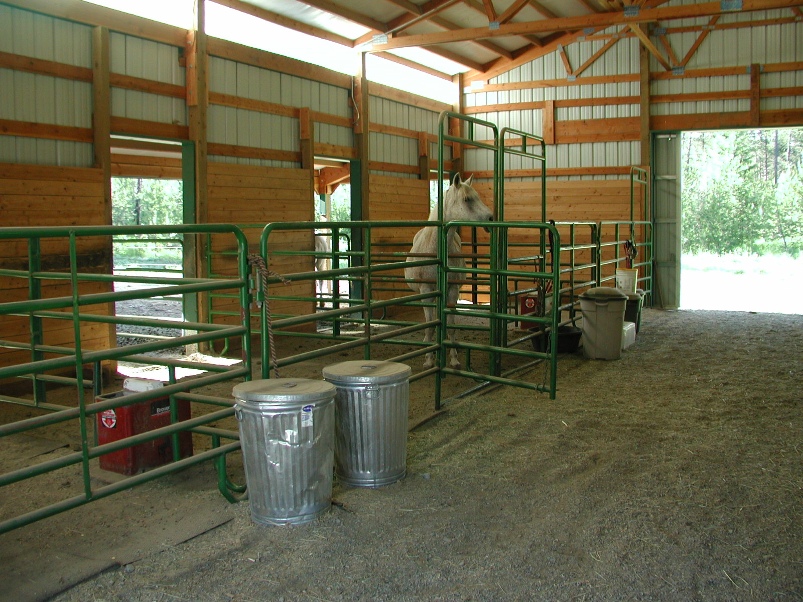

I have a pole building barn with 8 stalls, and i simply used 2x6 untreated DF#2 or better. I put them up 8 years ago..and have only had to replace 1 board that twisted badly for some reason.
My horses generally dont kick, so its not been an issue.
Ive seen others install several layers of treated plywood, but i dont like the treated stuff cause its poisonous if a horse eats it.
Even my bottom most layer of boards is not pressure treated, and still looks good as new.... just darkened with age.

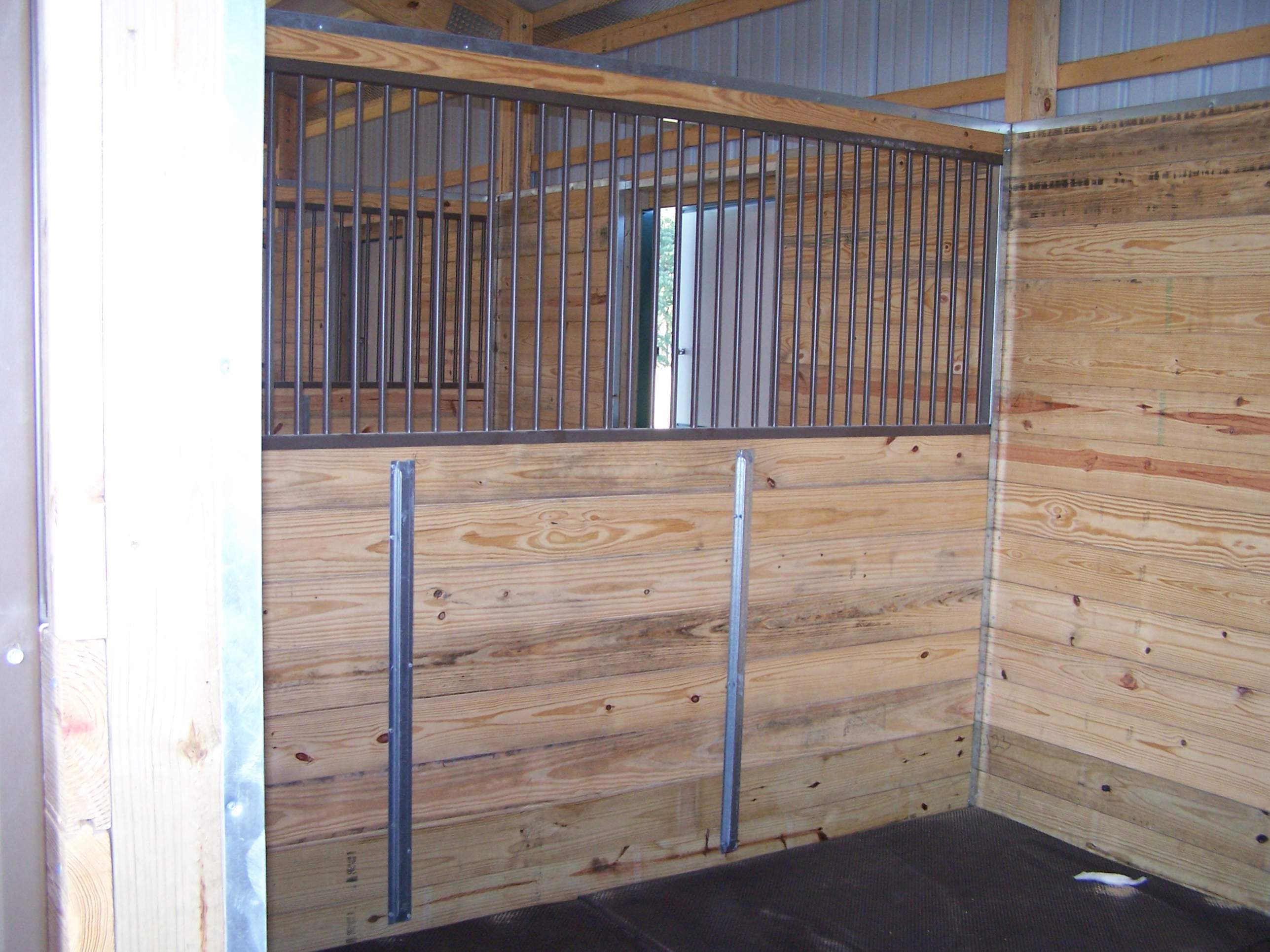

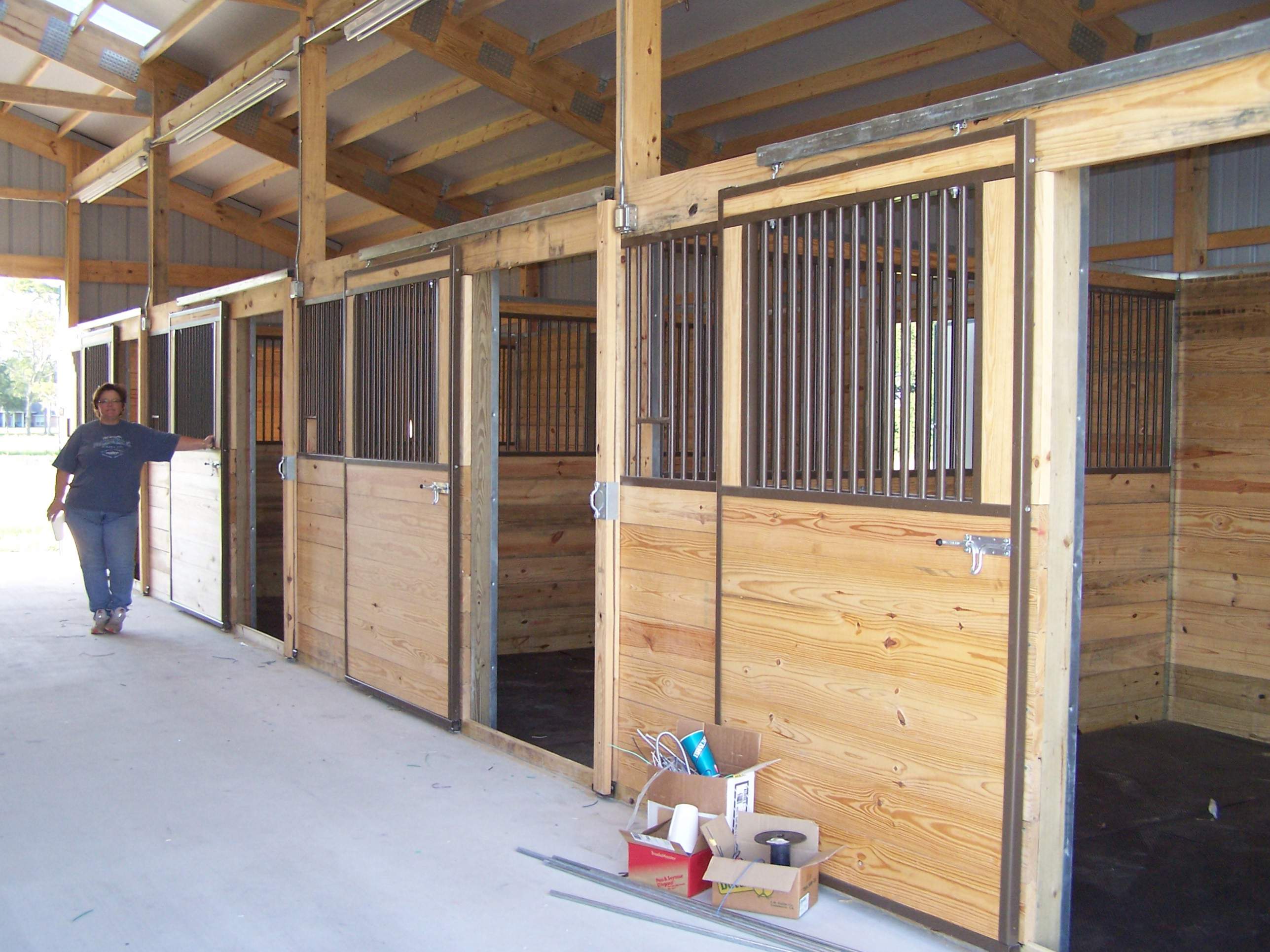

Our Morton stables has pressure treated 2"X8" tongue and groove at the bottom and untreated 2X8 tongue and groove above to 8'View attachment 270210View attachment 270211. Stalls are 12'X12' with corner posts and metal supports on the walls. We have had no problems with our warmbloods kicking a wall.
I vote for this method or similar. I built stalls inside a metal pole barn 20 years ago 12 x 12 with 4" x 6" treated posts including one in the middle of each wall. The sliding door hardware can be purchased as a kit and you add the tounge and groove boards to it. 3/4" EMT can be used for the open air part shown on the sidewalls. The door kits come with similar tubing.
You can't beat a sliding door for safety and for being out of the way when open.
When you have 1200 pound horses scratching their butt on the walls 2x8 tongue and groove boards properly supported will do the job.
We had an old barn once with 1" thick boards vertically on the inside up about 4 feet to protect the barn outside walls which were also wood. Big mistake. The boards tend to dry out and splinter as well as shrink. Guess where the splinters end up?
If you plan on using the stalls for a while it will be cheaper and safer to do it right the first time than spending time and money later for repairs and Vets to sew up wounds from the kick boards.
It is better, if you can, to not have metal exposed to the horses. They will kick it, lean into it and dent it, or get cut on an edge.
