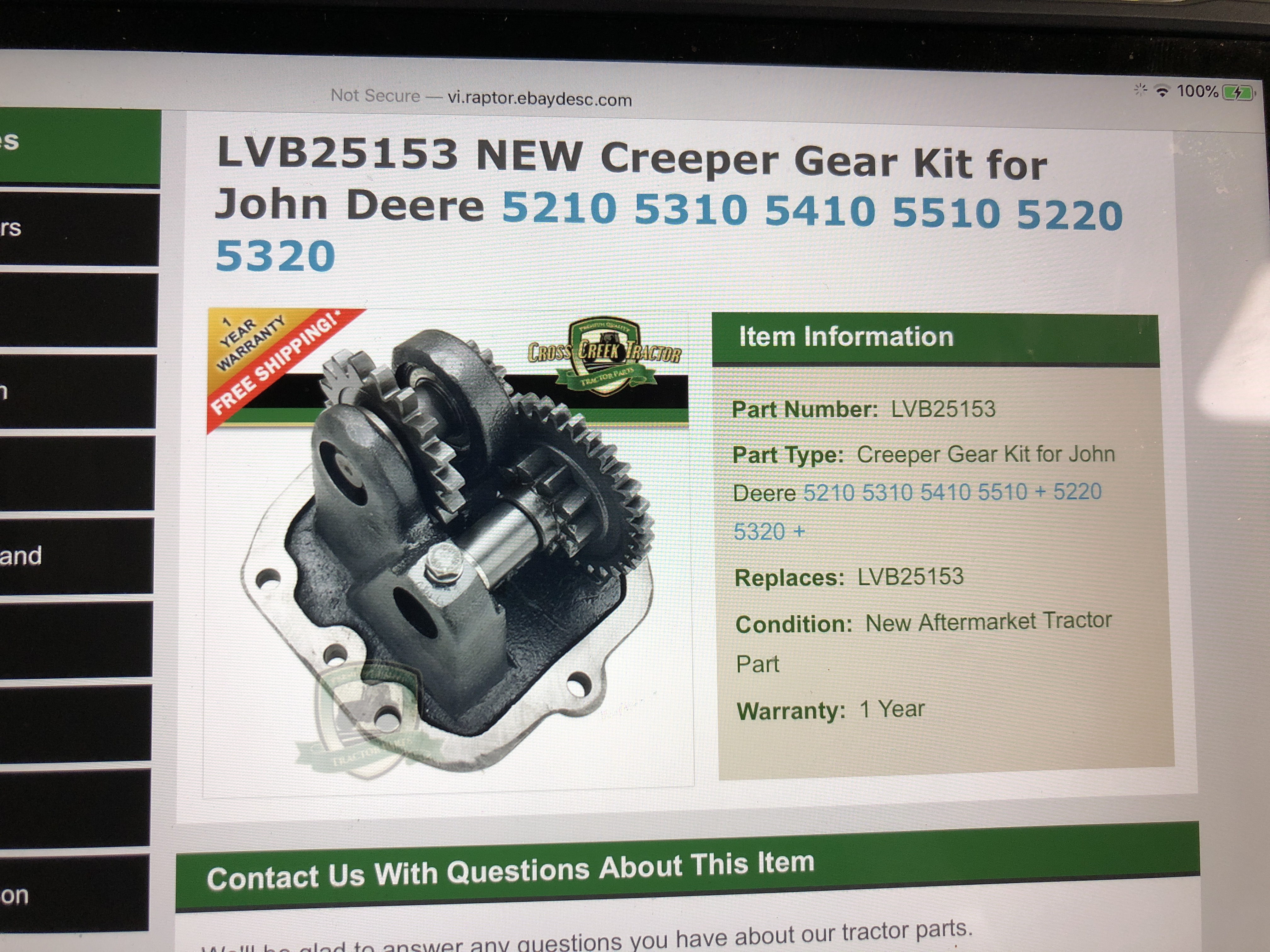

I saw this LVB25153 creeper gear kit listed & was wondering if any of you guy knew about or had info on it ?
Is it a easily bolted on option ? How does engagement take place etc ?
I have a call into this dealer ......
it says it fits JD 5425 which is a 4cyl with Power Reverser 12spd trans.
I have a 5093E & 5101E which is the same tractor.
I’M NOT HAVING ANY LUCK LOADING PIC :thumbdown:

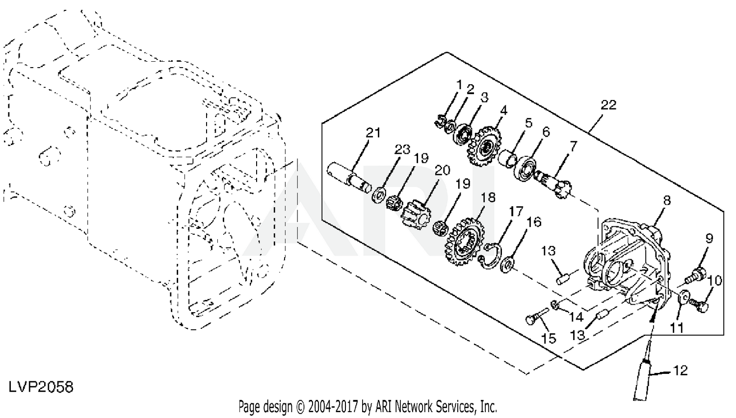

   / LVB25153 JD 5K Series Creeper Gear Kit Kit Info
Borrowed Internet pic
It does appear to bolt onto trans externally :thumbsup:
One dealer mentioned part# RE179398 (whatever this is) was either also needed or superseded the LVB25153.
They’d never sold one, installed one OR had ANY Instructions :thumbdown:
I hate to buy this & it not fit my 4cyl 12spd PowerReverser Trans then I’d be stuck with it for a showpiece
#9
I removed dog house off trans that you straddle & found a plate on top of trans under the seat track.
This pic shows the creeper gear set assy bolting on right side of trans (like jd110 mentioned) under the cover around both shifters where I can’t see.
A very helpful JD dealer is doing research on this & supposed to be getting back with me ....
Borrowed pic from web
My 4cyl PowerReverser trans does NOT HAVE a plate on right side of trans to accept this gearset.
Unless it bolts into the TOP of trans under the seat track bracket :confused:
