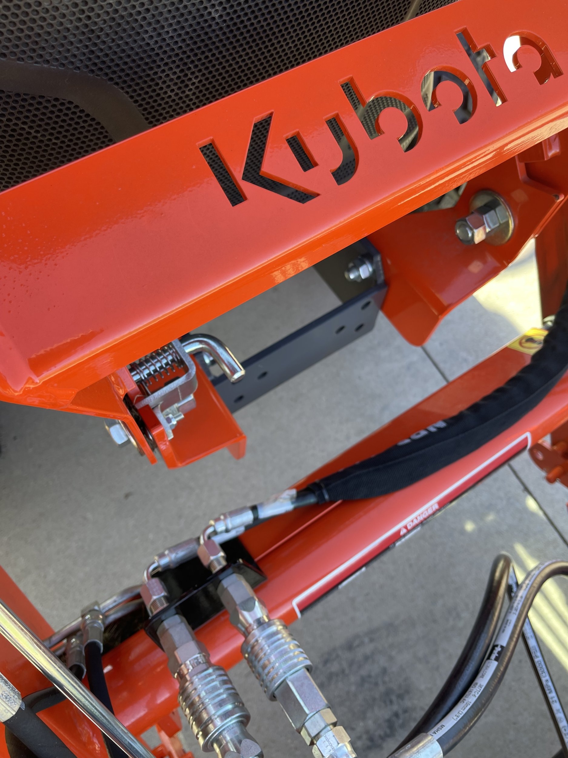

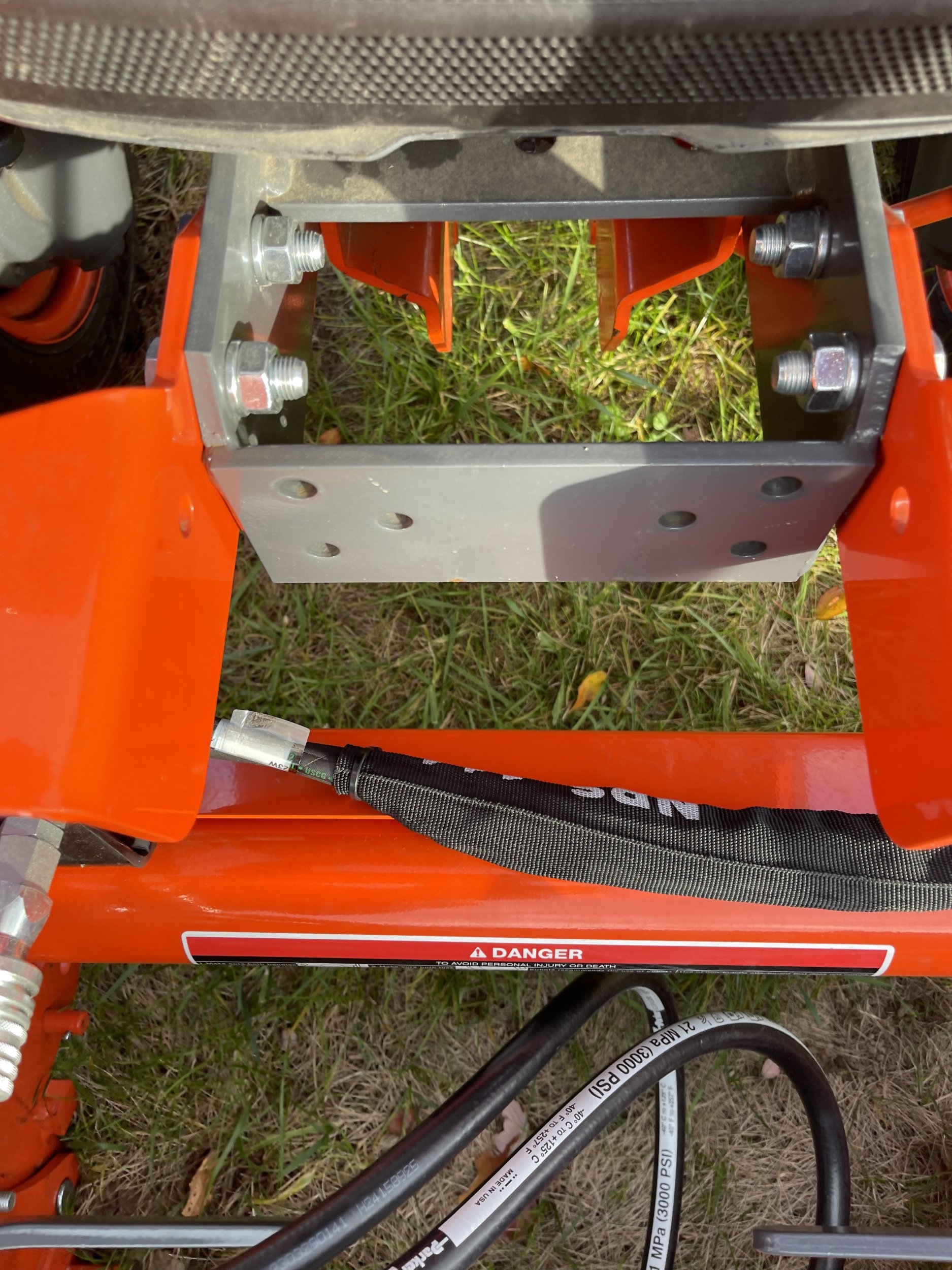

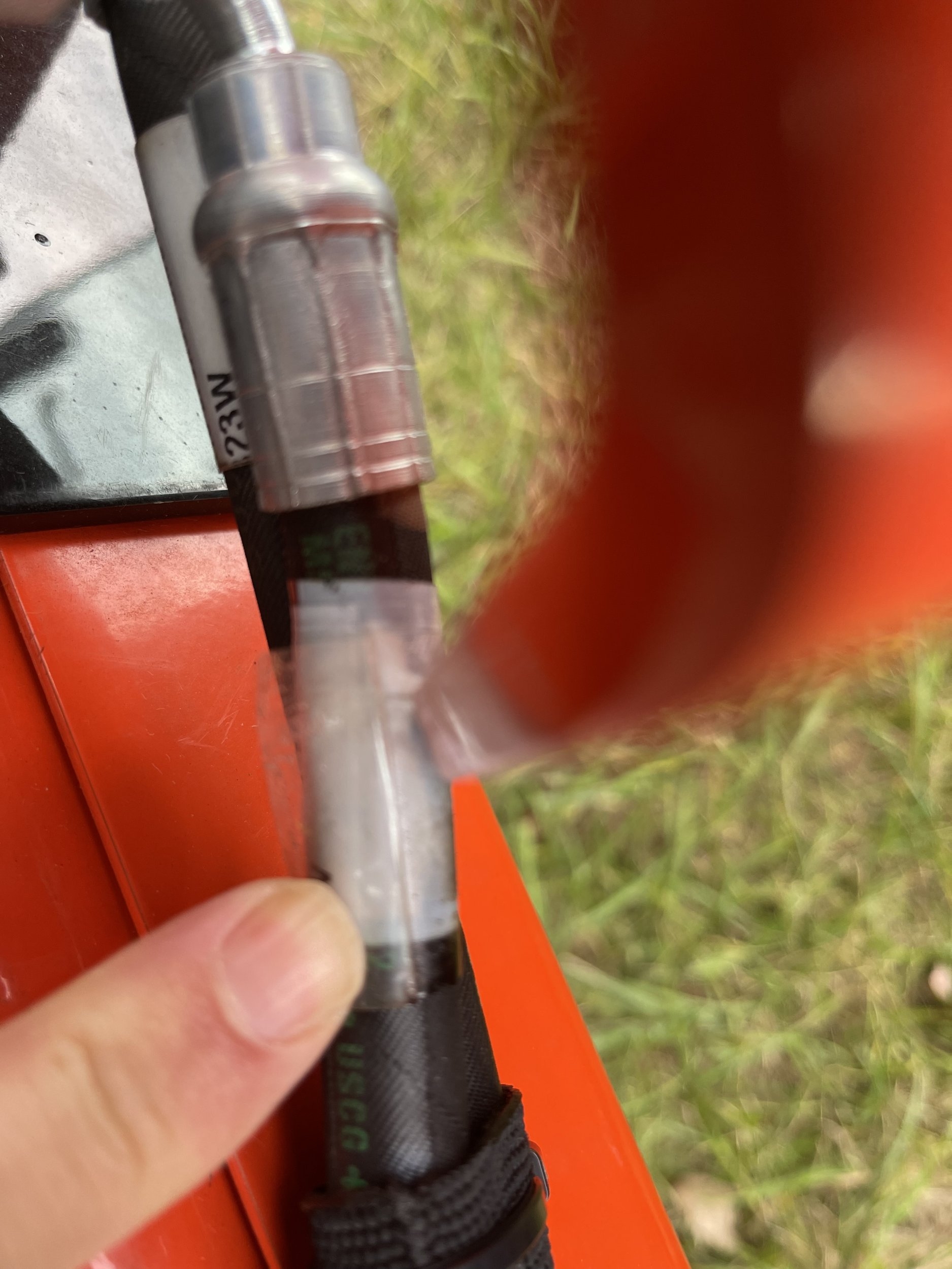

Just an fyi item. I recently had the Land Pride 3rd function installed on my LX2610, cab version, along with the STB1060 front blade. I noticed that under certain conditions the hydraulic hoses were contacting the grille guard near the solid hose crimp for the fitting.
The solution was to move the guard back towards the hood. Since the owner/salesman stopped by to get a better view point he helped me relocate the guard to its correct position. The pictures show three holes per side.
This only became a problem when the 3rd function is installed.
