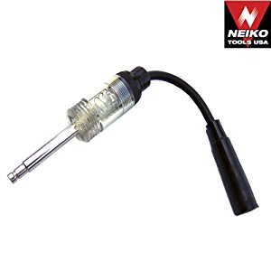

I would pull the spark plug once it dies. If you don't have a spark capable of igniting the gas it should be wet. I would take it to another engine that you know runs and put the plug with on the plug and put the metal base of the plug against something metal on the engine. Be careful as you don't want to get shocked. Try starting the other engine (make sure there are no switches turned off). As you try to start it look at the plug. You should see a spark jump across the plug from the center electrode to the ground strap. If you don't then you most likely have a bad plug and the spark has found an easier path to ground.
If the spark plug is bad replace and drain all of your gas as it may be contaminated. Also get a couple spares in case you foul the new one trying to get it running again. If the plug is good and it's firing for a brief moment then I would put the plug back in. If you have an AutoZone near by I would pick up one of these:
OEM In line ignition spark tester 25227 - Read 4 Reviews on OEM #25227
It's cheap, less than $10. With it installed between the plug and the plug wire try starting the engine. If you see a spark then you can rule out an ignition problem. Can you unplug the coil so there is no spark? If so then do so. With the plug removed (if you don't have the coil unplugged the plug wire can shock you) put your thumb over the spark plug hole and try turning the engine over. You should feel the engine suck on your finger. You can rent a compression tester from Autozone if you don't have one but as long as you feel it suck chances are there's enough to start the engine.
