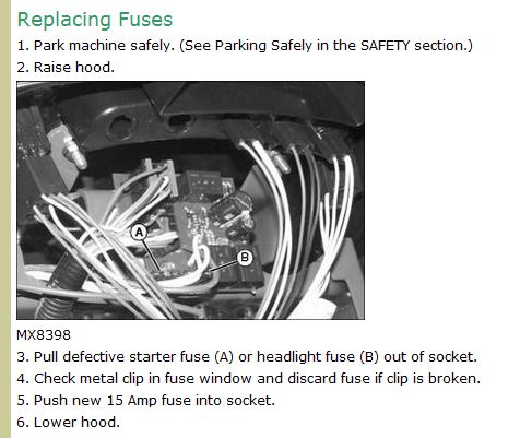

my lx279 just stopped whilst mowing, traced it to a blown fuse, problem it blows as soon as you turn on the ignition have disconnected all engine wiring at senders ect still blowsi disconnected a plug that runs back to the ignition swich just in front of the battery fuse didnt blow traced wiring to a circuit board but cannot detect anything wrong any any ideas appreciated cheers paul
/ lx279 #2
What fuse is blowing? See attached photo.
Appearently there are only two fuses on the circuit board. The starter fuse and headlight fuse.
