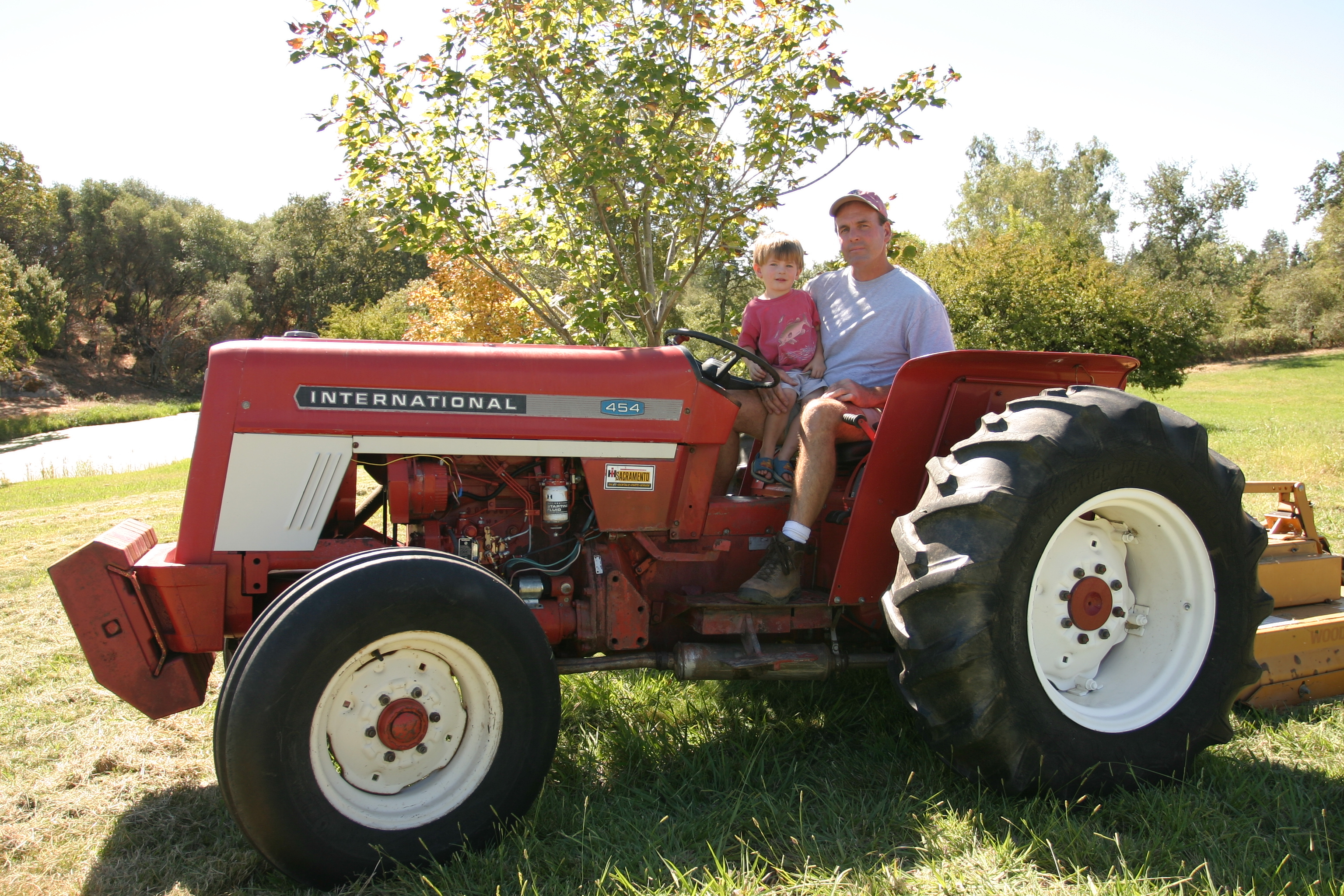

Oops, forgot to mention this one. 3 cylinder beast. Had two rear PTO's at different speeds.

The 454D I had was a 3 cylinder diesel and it had so much power I could run a 84" mower on the high PTO (1000 RPM I think) at just above idle and it breezed through everything but the tallest weeds. Mower was a 540 and thus the reason for the slow engine speed.
