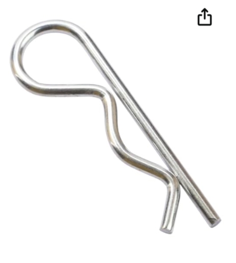

Just get some large “R”clips and push them all the way through until they’re hanging, brush and limbs are not gonna pull them out, been using them this way all my life

Yes, it seems like tractor 3pt, FEL, and BH work will often open up my Lynch Pins and losig them can allow a shaft to slide out and bend things. Over the years I'veI replaced small Lynch with R pins, and the larger ones with a hardened bolt and nylock nut.
If I do use a Lynch pin - usually because it fits the hole perfectly - then I safety-wire it everytime.
