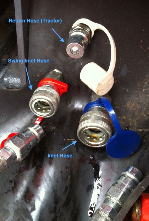

Hi folks,
Thanks for the replies, things are definitely becoming more understandable.
@Stonehaller - yeah the color coding on your L39 seems to be exactly the same as the M59 (I've annotated the picture with what my manual says).
Can I not just spin my seat around and use those ports as if I were running the backhoe. Though the directional valve levers need to be in the 3-point hitch position - do they shut off hydraulic flow to those ports?

   / M-59 and Wallenstein BX-62 Hydraulic Feed
Reading through my manual there is a NOTE in the Hydraulic Unit section:
* When the hydraulic couplers at the right of the tractor are utilized as a hydraulic outlet, swing lever is switched to "with backhoe" position.

Hi folks,
Good thing you checked. I mixed up the main supply and return. That's what happens when you do not have the tractor or manual in front of you.
On the L39 there are two separate levers that control independent valves for the swing outlet and the main outlet. I can set the main to go the to three point and the the swing to go to the backhoe which I then connect to my remotes for the top link and chute rotate. If the M59 has the separate operated valves then you should be able to do essentially the same thing by connecting the swing inlet and return to the chipper feed.
