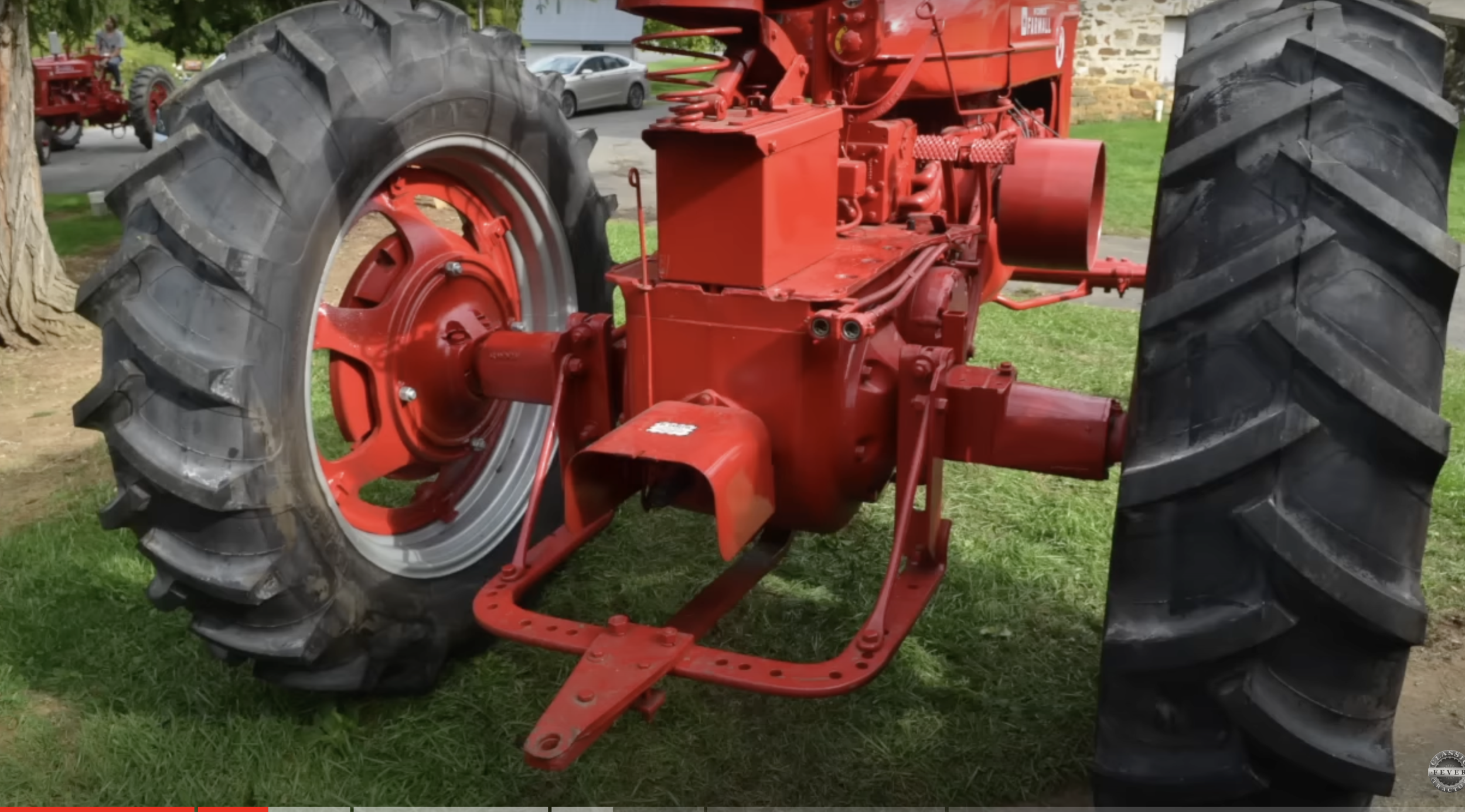

Moved back to the family farm in Indiana about a year ago, and finally getting settled in on the farm. Mom just rents out all the ground and we have no equipment other than Grandpas M that he started farming with. It was our auger tractor when I was growing up. Had a manual trip loader on it when I was a kid, but that loader is long gone. I started it last summer and ran it up an down the road, and then parked it again. I've been wanting to find a tractor that I could use to move dirt, gravel and just have something to use. Can anyone guide me on adding three point to an M?

Nice tractor. The guy next door had an old M that he used for everything. It cost near nothing and started and ran just fine for many years. It was so quiet that you could still talk when it was working. What a nice old machine....When he sold out, the M went with him into retirement -that's how good they are, part of the family. And every part is still available.
Originally, his M didn't have a 3pt hitch, so he bought an aftermarket one for it. It easily handled a heavy 8 foot back blade. Not as well as our old JD with a factory 3pt - but good enough.
Fast forward to tonight, and after seeing your message I just did a google search. Guess what?? It turns out there are half a dozen firms still making a simple bolt-on 3pt hitch for the Farmall M ! Who would of guessed? They mostly have an oversize single hydraulic cylinder so they can run off that little 500 psi hydraulic pump that was standard on the M. The problem seems not to be finding one, but deciding which one to get.
Prices range from $800 on Ebay to twice that for fancier ones. They all look about the same as the 3pt that Jim and I put onto his M back 40 years ago. Simple bolt ups installation with no welding and didn't even take a whole afternoon to do the job. That's all it took to make a good old tractor into a user. Looking at those kits, they do vary. They are all so inexpensive for what you are getting that I'd go for quality over price.

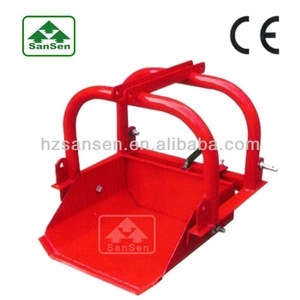

You can also find a 3pt back bucket scoop that works for lifting and carrying. Here are some pics. That will do some of what a loader would do. I probably wouldn't put a front end loader on an M unless it had the wide front and power steering - but of course those parts are available too.
