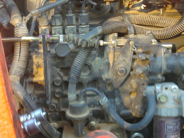

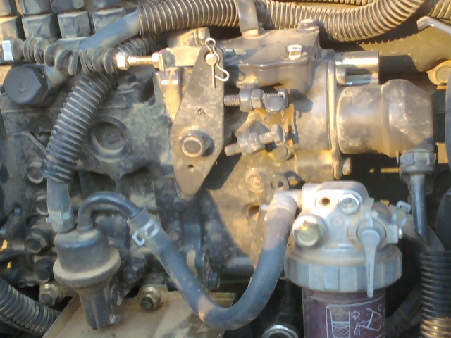

How much would u recommend to turn the max fuel adjustment?
/ M5040 injector pump #22
Start with 1/2 turn increments and then try it. I would stop once you get significant smoke under heavy load.:thumbsup:
