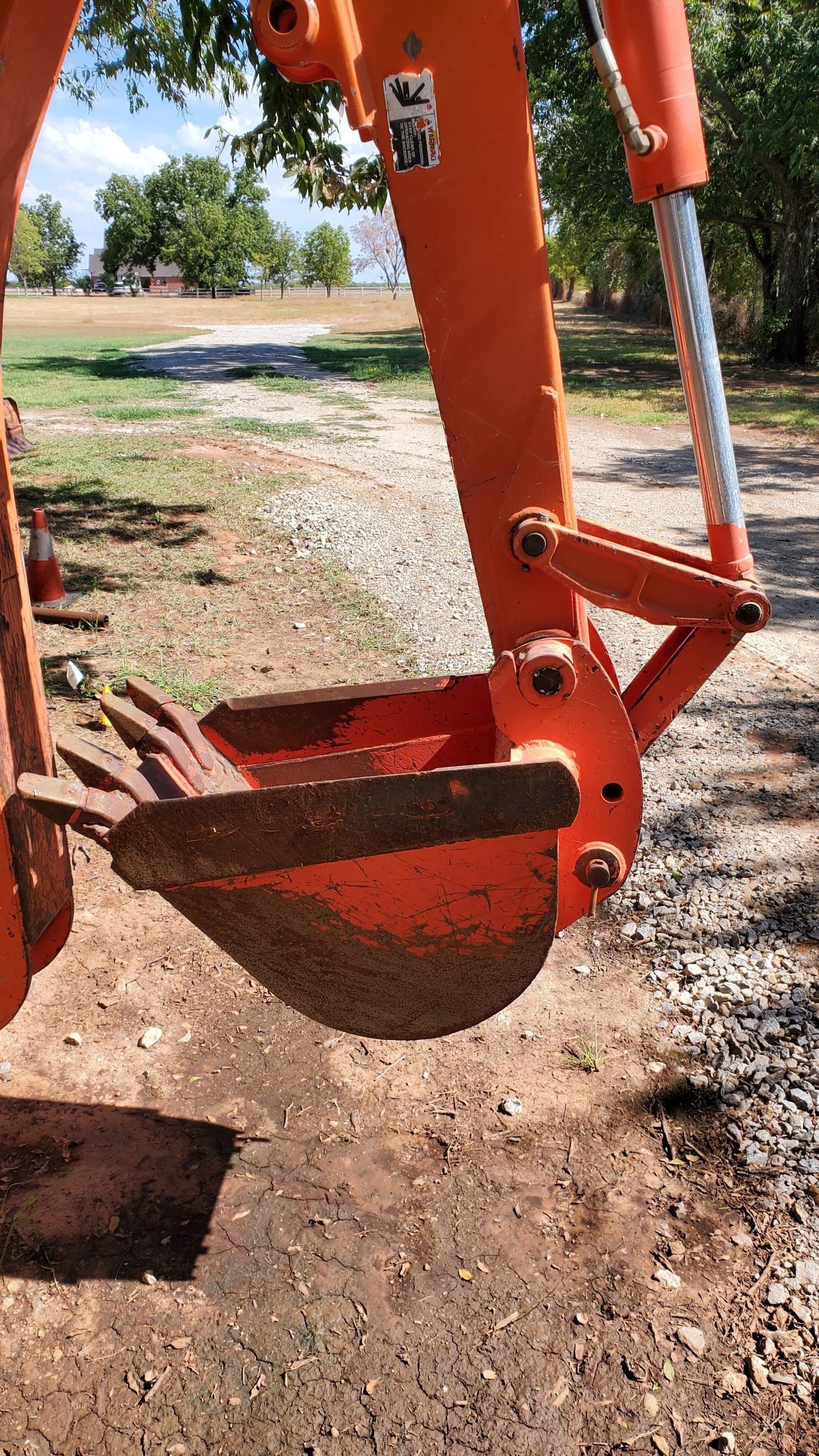

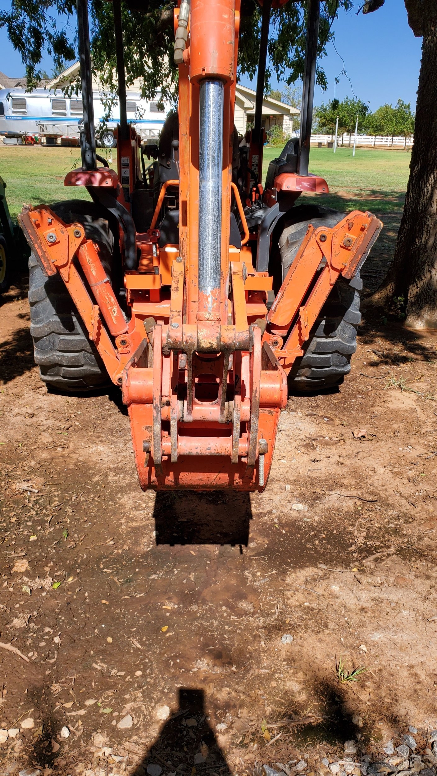

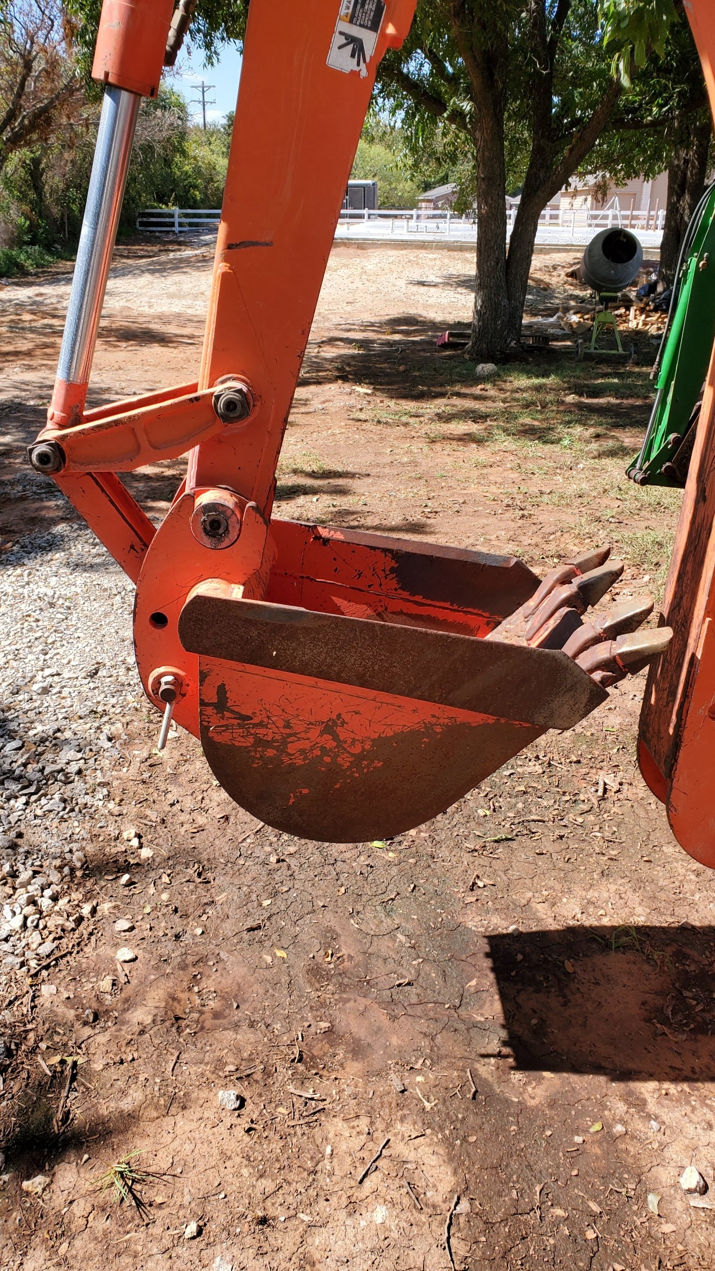

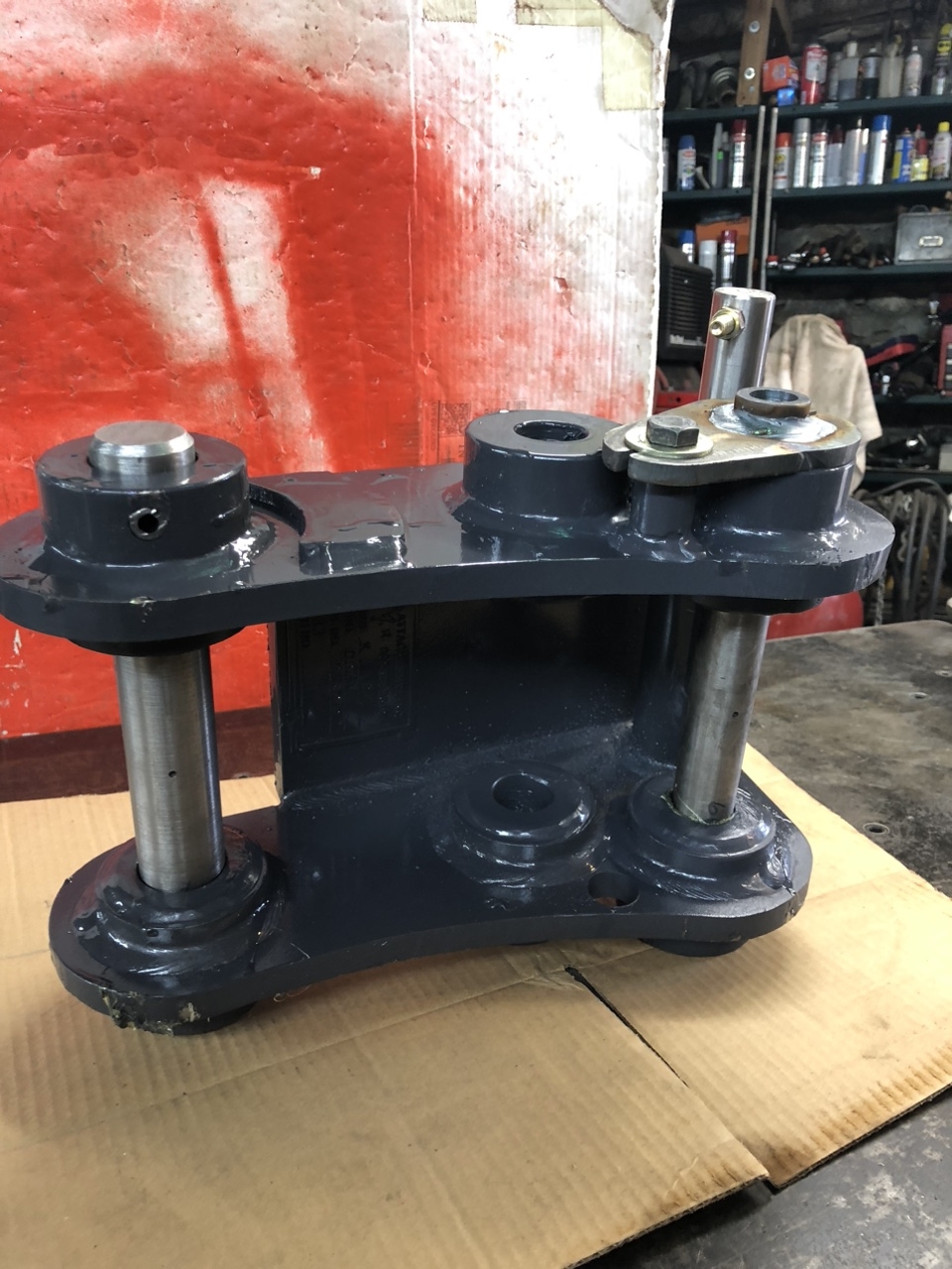

The above quoted post and others in this thread are quite helpful. Unfortunately, without photos, it is difficult to determine whether my 2014 M59 has a quick attach (I think it does), and if so, what type it is so that I can figure out what buckets would be compatible. I am posting a few photos of the current backhoe bucket setup on my M59. Can anyone confirm what type of bucket attachment setup I have and what buckets would be compatible based on these photos?

You do have BT4580 Kubota quick attach. Buckets may still be available from Kubota. Used ones are rare.

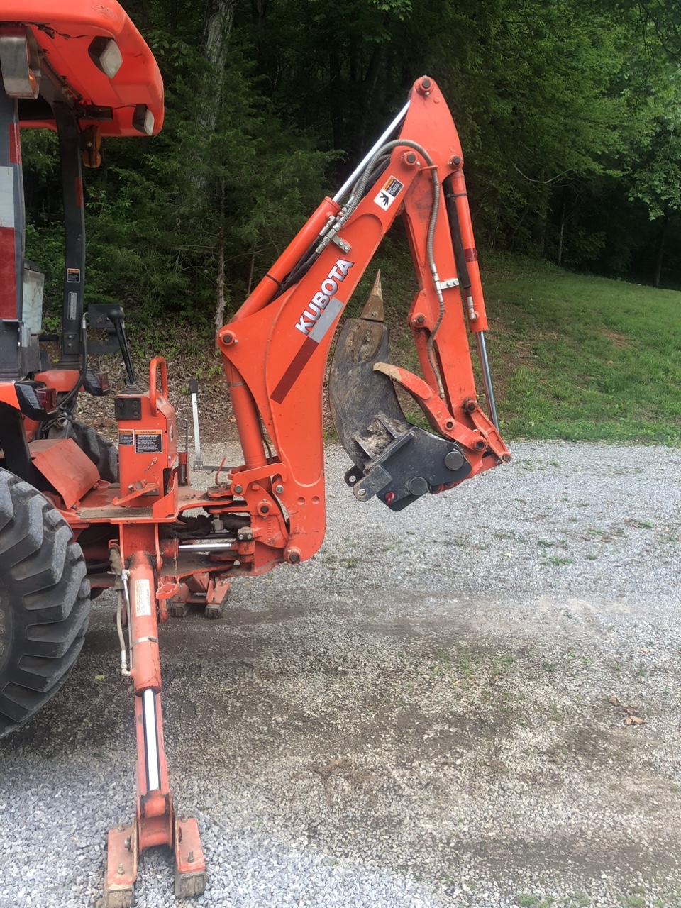

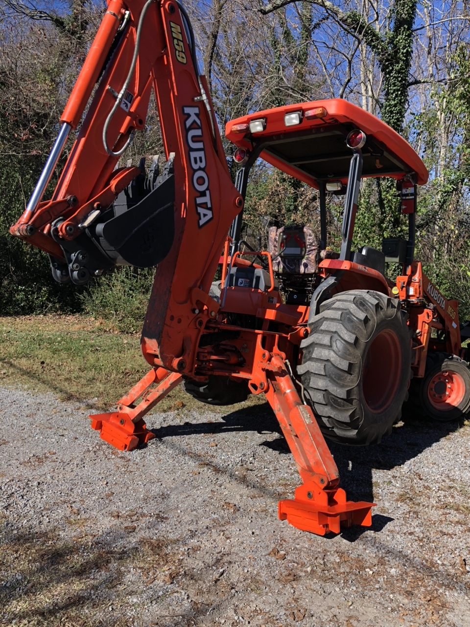

My 2014 M59 had pin on bucket with thumb. Could not find used buckets. Wanted to convert miniX but way too expensive from Kubota.

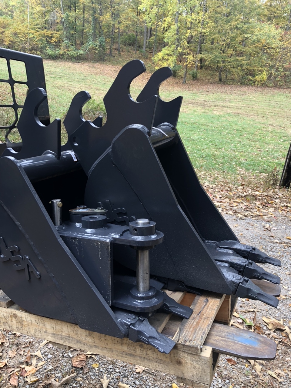

Mr. M59 shared with me his conversation to miniX quick attach using USA Attachments PGC-100, M59-KX040 quick coupler. Bought coupler, 12” , 24” and later ripper miniX attachments. Did require some modifications and welding. Much easier than changing ears.
Have really enjoyed the modification. Buckets, ears and more attachments are cheaper, heavier duty and readily available that fit several models of Kubota minix and M62.
Made a adapter to even share minix attachments on the B26.

Bought my M59 used as a landscape model without a backhoe. Took a couple years to find a backhoe. The 2’ bucket bottom had broken like yours but had been professionally repaired. Mr. M59 commented that was a common problem. Sold that Kubota bucket for nearly what a excavator bucket cost new.
I don’t know enough to comment about different couplers. My thumb was not compatible with the Kubota KX conversion and replacement was costly. Mr. M59 showed how he modified his thumb to work. Mine had slightly more interference to adjust to. Mr. M59 did his conversion with only a grinder. Thumbs are addictive.
Jim at USA Attachments made a great package deal with their M59 adapter. Free upgrade to ESCO teeth at the time. Smaller, sharper and maybe longer lasting. Good for the M59. The Kubota excavator quick attach couldn’t be easier to use. Increases the value and usefulness of the M59.
