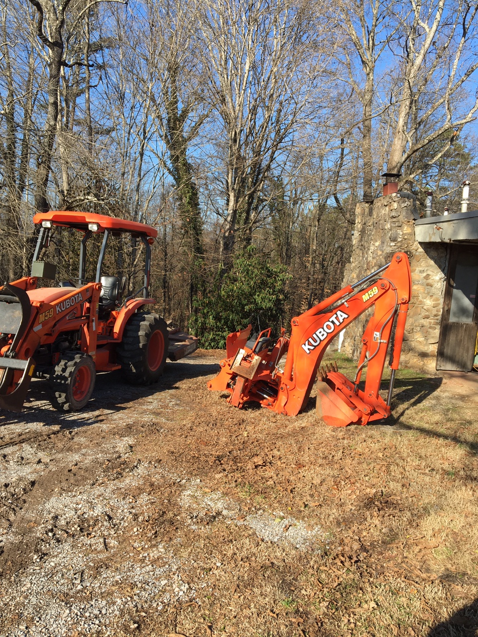

After looking for three years finally found a used BT1200 backhoe attachment for my M59. Delivered yesterday. Heavy rascal. Would been a hard lift for a smaller tractor. Has thumb without quick attach bucket. A few bumps and bruises but good low hour shape. Have to install couplers on my tractor to connect.
Saw this backhoe for sale in a large Canadian auction after it was sold. A dealer above Detroit bought it with other equipment to resale. They helped with finding transportation for 500 miles to Knoxville Tennessee. Dreaded and fretted about the risk of buying without acutually seeing it in person but with a reputable dealer helping it all worked out.

   / M59 BT1200 backhoe attachment
#9
With the thumb and 24” bucket installed about 2650#. Plus bucket full with a big block of ice!
Straightening up the sheet metal deck. Deciding on couplers. The foot steps on the out riggers are mangled? Maybe the bucket could reach them?
I find the rubber out rigger pads on past backhoes most useful. $160 option. I need to make sure that is for 4 pads.
The bucket toothbar has been ripped. Looks to be professionally repaired and reinforced so time will tell.
