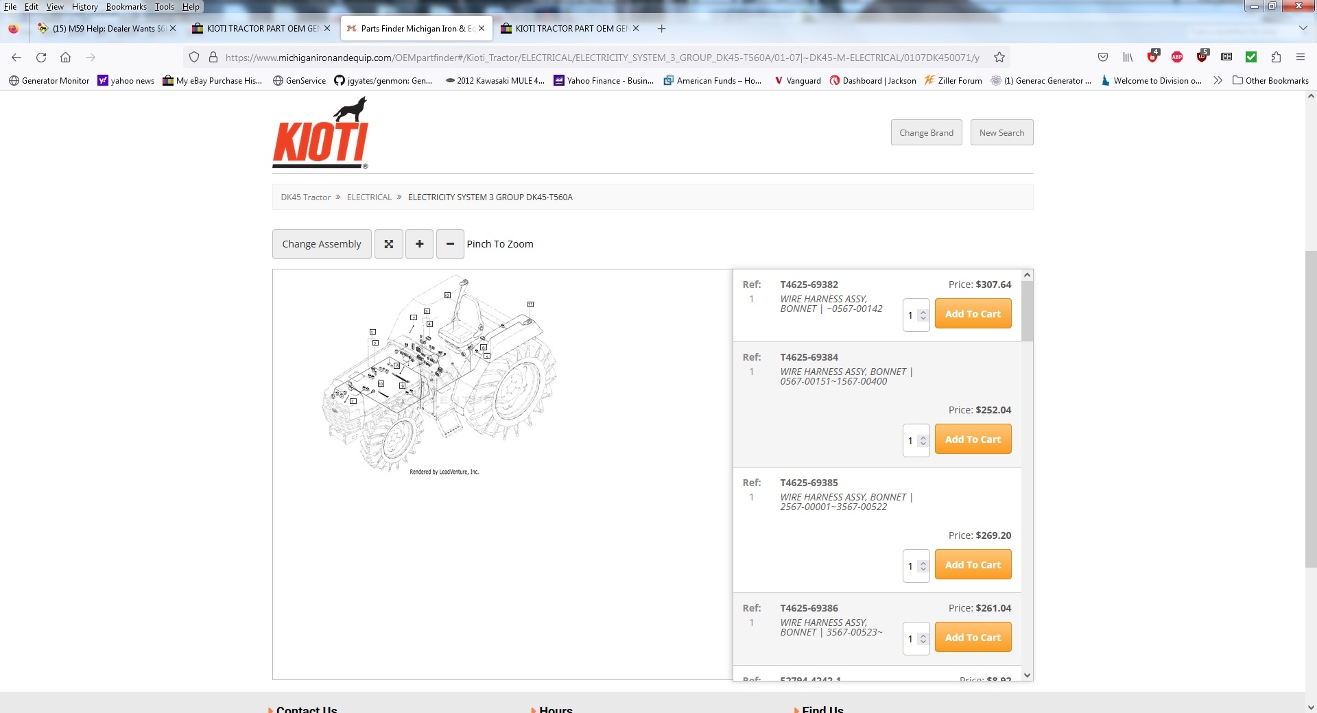

How the he** can a wiring harness cost that much. Mice ate mine somewheres…could not locate problem. I didnt feel like removing all the loom and tape, so i replaced harness. Kioti only charged me $295 for entire harness, and it took about 3 hours to install it.
I kept the old harness always meaning to trace and repair it…..someday.
   / M59 Help: Dealer Wants $6K to Replace the Wiring Harness #20
Well, first off, the OP opined that the dealer was getting sick of working on his tractor, so likely the price was inflated.
Secondly, $295 sounds woefully inadequate for a wiring harness on a tractor that was built in this century. An 8N, OK.
Similarly, I can promise you that even if a factory trainer Kubota tech could replace it (mind all the grime that is in the pics) in 3 hours, ain't no way that is the published labor cost (no doubt in part because of the anticipated grime).
