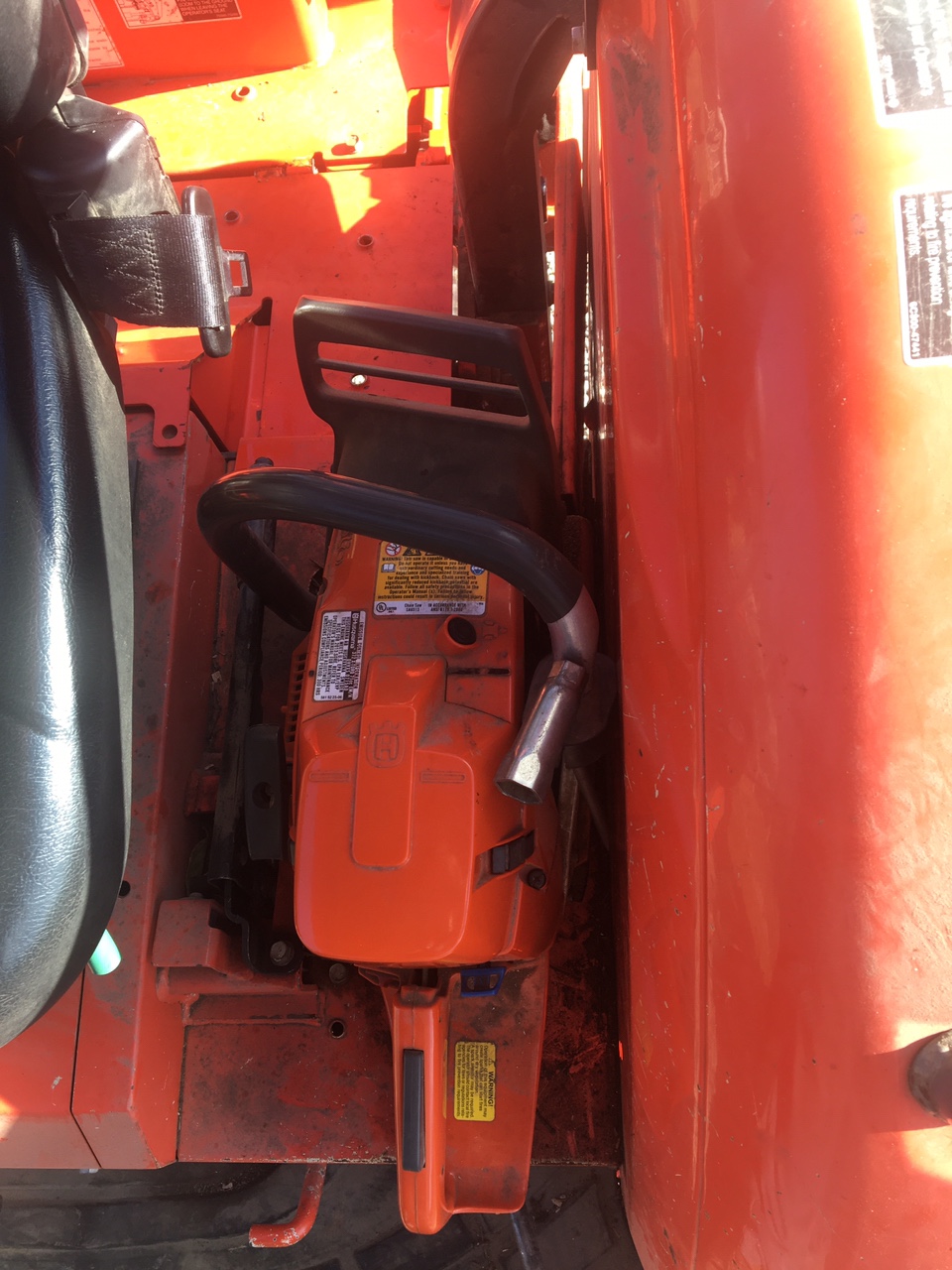

Carrying chainsaw on M59. Saw wedges in there nicely and stays put.

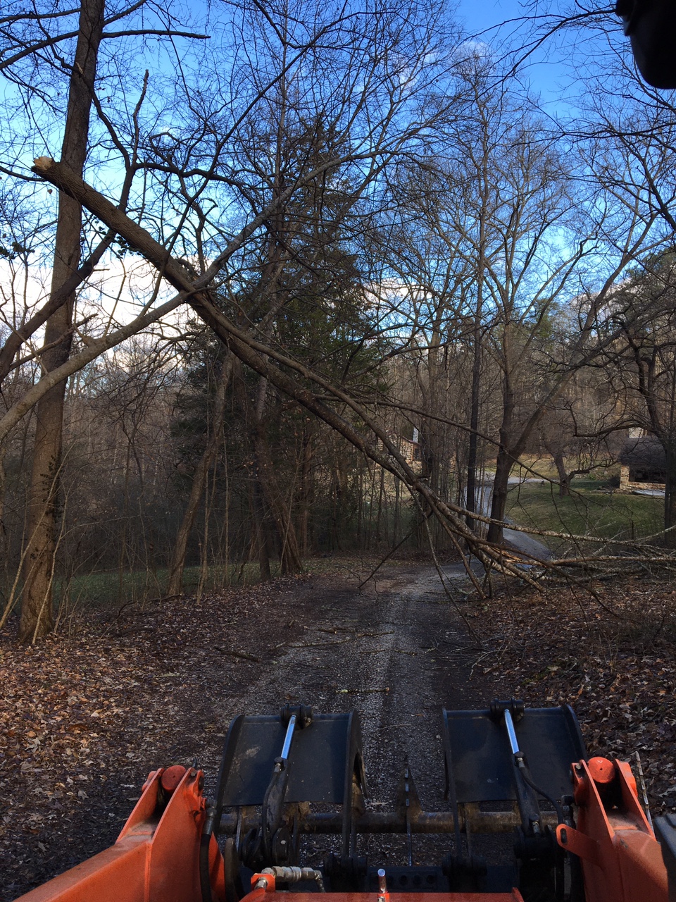

Last night wind and rain storm left limbs and one pretty good size tree “widow maker” across the driveway.
Awesome M59 could safely break an 8” maple to bring the ash top down. Then haul if off in 25-30’ lengths. Took about a hour.
Tree cutters would charge $800 just to cut up and over double that to cut and haul. We all earn our keep today.
