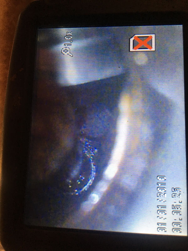

So I finally got some time to get this repaired. Talking with dealer he estimated over phone $1200-1500. but as soon as they saw it, it became $5000 plus parts. They have never worked on an m59 so they were shocked to see how much has to come apart. I think it's going to have to leak.
   / M59 front drive shaft leak.
#23
I brought it home and took front drive shaft off to try and absolutely verify the propeller shaft is leaking and not from axle. After you take drive shaft off which is pretty easy, this collar you see in pic slides off. The other two pics are iPhone pics I took of a handheld snake camera. You are looking at the propellar shaft and the seal that is about 5" in housing.I think it's safe to say propeller seal leaks. On the positive side, I have never had to add oil because of this leak, it minor compared to the 12 gallons it feeds from.. On the last pic it is a page from service manual. It says there should have been an o-ring on end. There wasn't.

The 4wd output shaft and transmission input shaft looks identical to my 5240. I did not have to remove the mid case as your instructions say. You can get to the 4wd output shaft seal with a couple of picks after you have removed the snap ring. It really wasn't too difficult when I did mine.. I consulted the mechanic at the dealer beforehand. He has done several. You'll want an extra set of hands though. You need to keep constant pressure on the shaft to make sure it doesn't slide forward after you remove the snap ring. I am told it is very difficult to reinstall it if it comes out.
I also lifted up the mid case with an engine crane so that it was tilted up in the air. We lost maybe a 1/2 gallon of fluid that way.

Does yours have a clutch housing? The seal is about 7" deep.
   / M59 front drive shaft leak. #26
Not sure I understand. The clutch housing stays bolted to the engine. You split the tractor between the clutch housing and the "mid case". Once they are apart, mine looks identical to the pictures from your manual.
#27
I was thinking you meant you didn't split the tractor and replaced seal from propeller opening. No, you don't take the mid off, just split like yours.Difference is the loader frame makes it labor intensive. That pic is from a service manual, not instructions for seal replacement.

Dropped off at dealer last Monday and today it is back together except front drive shaft. Waiting on sleeve that slides over propellar shaft to keep the seal collars from backing out. Funny thing is dealer said propellar shaft was not leaking, it was the main transmission seal. So both seals are replaced. Sorry no pics but no way to get time to go by dealer. I will say the m59 is pretty worthless without the backhoe on and not in 4 wheel drive, very front heavy and get no traction in rear.
