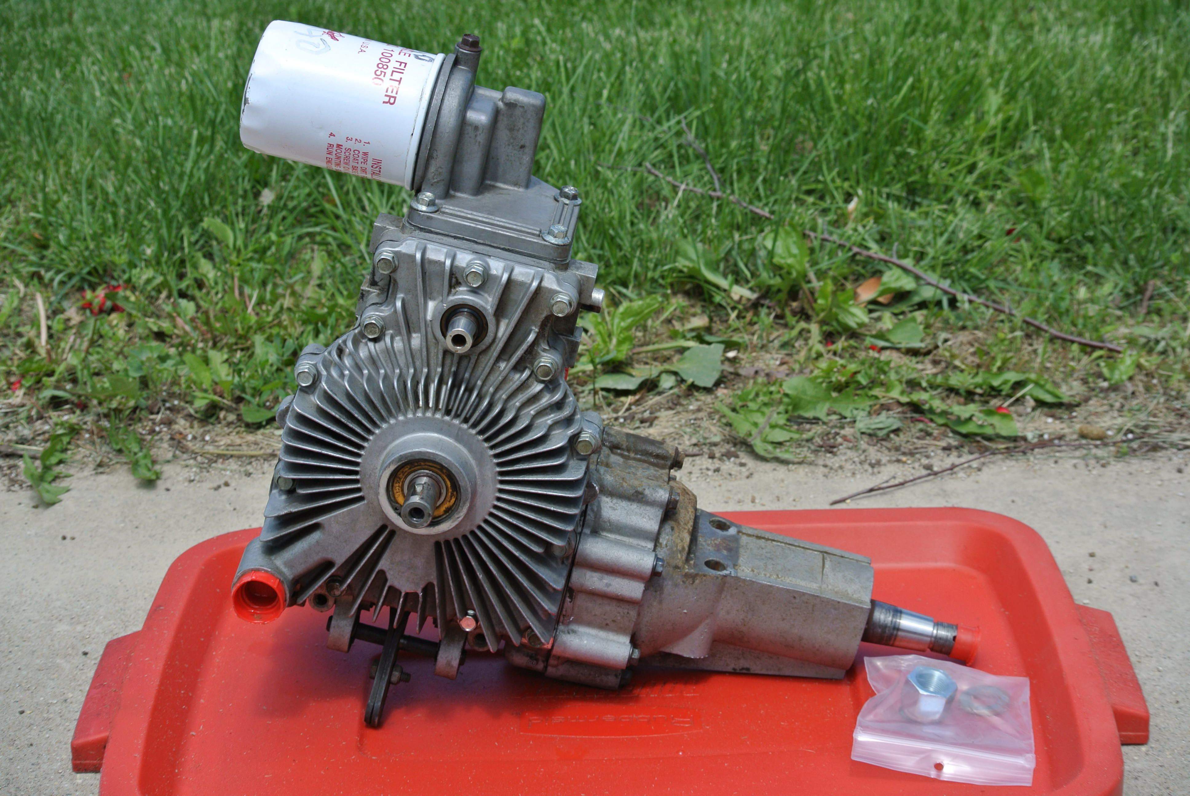

That is what happened to our mower. I don't know exactly what you mean by chattering. Is it sound or jerky motion like something is slipping? Our mover developed slipping of tire on the rim causing sometime very jerky operation or complete loss of power. It took for a while to figure it out only after we bought and installed new transaxle. The transaxle is for sale now for about half price of new one.
Push the mower against immovable object such as tree and let somebody observe the wheel while trying to go forward. The tire should slip on ground not on rim. There is not much what can go wrong with pumps and motors on commercial mowers. The mechanic told me they should last several thousand hours.
/ M65 zero turn drive problems
Got the word today. Hydro pumps are bad. One is shot and one is below spec. Ouch
/ M65 zero turn drive problems #8
I have one for sale for about half price of new if it would fit on your mower. It has about 1000 hours.
Edit: Just re-read your post. It will not fit.
