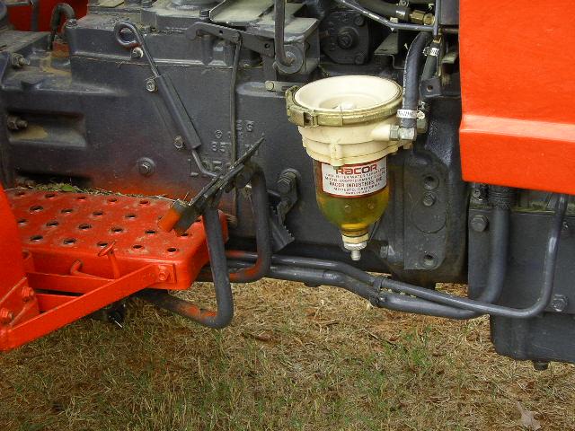

I'm with ya!!! Your preaching to the choir. That's why I have one of these...But I don't have a clear plastic crankcase (idea?).
This one pulled about 2oz. of water right after I put it on, nothing since. My L2500 just had a regular spin on filter, couldn't see anything. I had these for over 20 years(back when I was pulling wrenches for a living), finally got a use for it. Filters readily available.
Rob

That is super smart! /forums/images/graemlins/grin.gif
As would be this -> <font color="blue"> a clear plastic crankcase </font>
