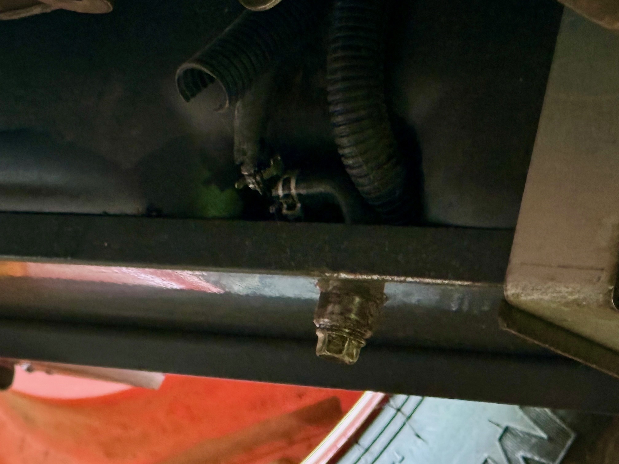

I have a M7060 that is leaking fuel from the line where the line meets the tank. Short of replacing the entire line, what can I do to address the issue? I'm thinking of splicing/joining another section via nipples to increase the length. I guess I'm asking more of what I would need to do this.
This has already been repaired once by the dealer and they cut the end of the line and pulled it taught to the "nipple". I'm thinking it may have torn due to tension. I've included a picture of the area where it's leaking.

I agree either add a double hose barb fitting & extra section of hose or replace hose from tank to water separator.
