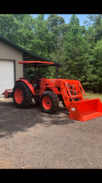

Pics or it didn't happen..... ;)
   / M7060 Tire Choices
#32
   / M7060 Tire Choices #33
Yes!!!! That looks great!!!! Tell me again what sizes they are??? Thanks for the pic!!!
   / M7060 Tire Choices #34
Unless you need it that narrow for attachments, I'd suggest setting them out a notch or two. It will handle much better and ride better. Less flop from side to side.
That tractor doesn't even look like a 70 with those tires!!!
FRONT - 320/85R20 R1W ALCE FRMPRO
REAR - 420/85R30 R1W ALCE FRMPRO
#36
Yeah wanted the narrowest setting due to my spacing of the Rows. Rear span is still 74"
