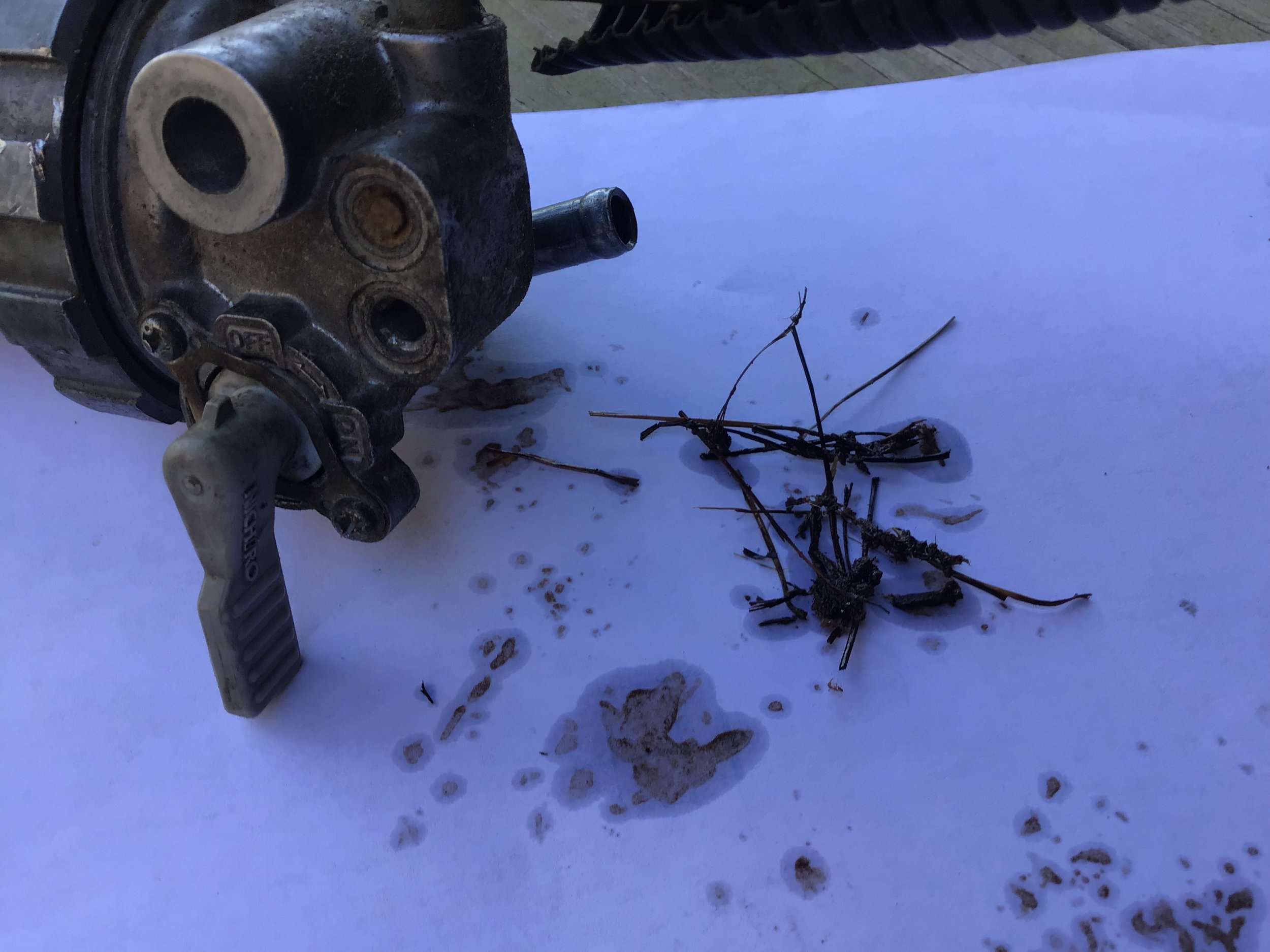

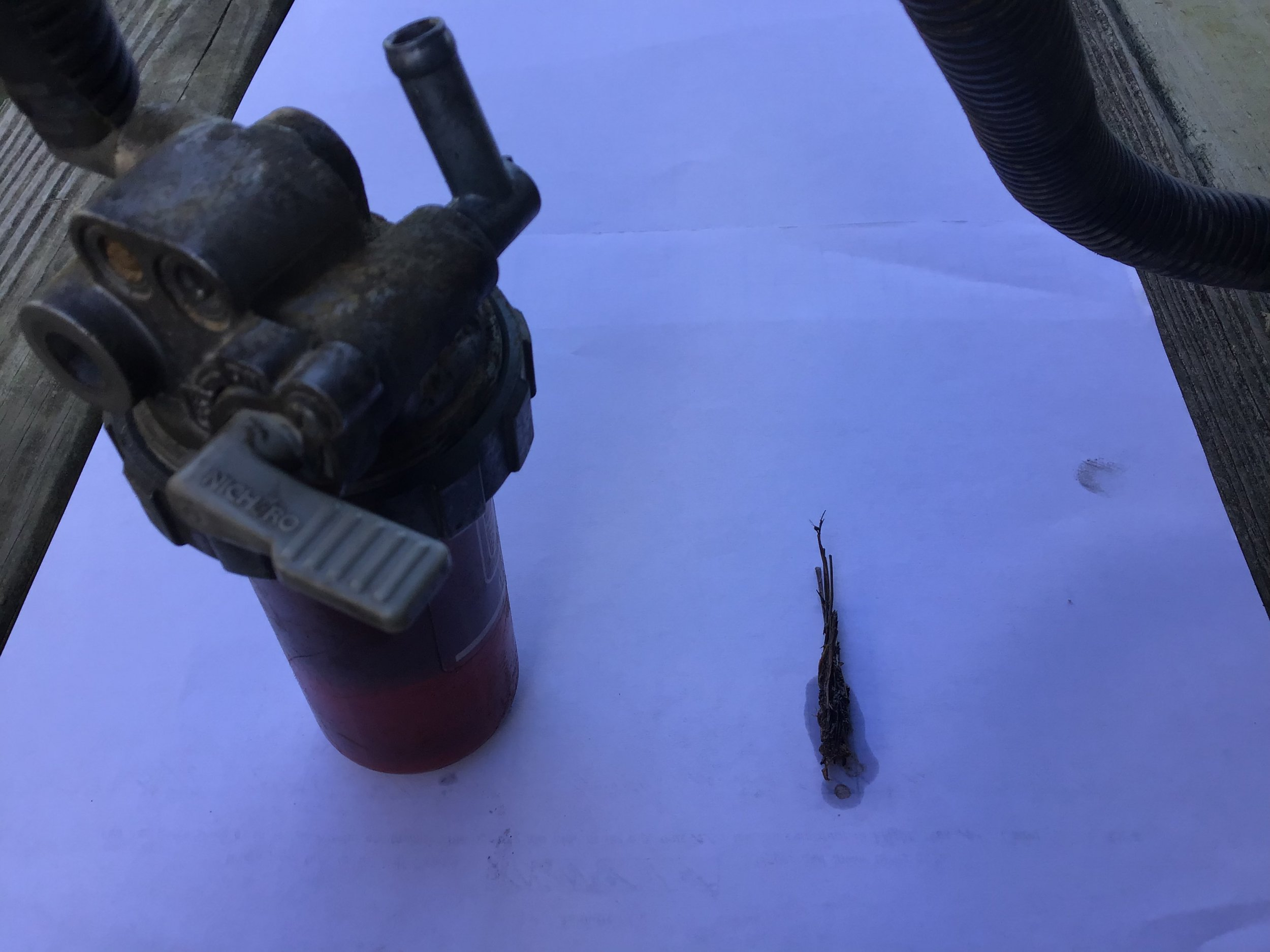

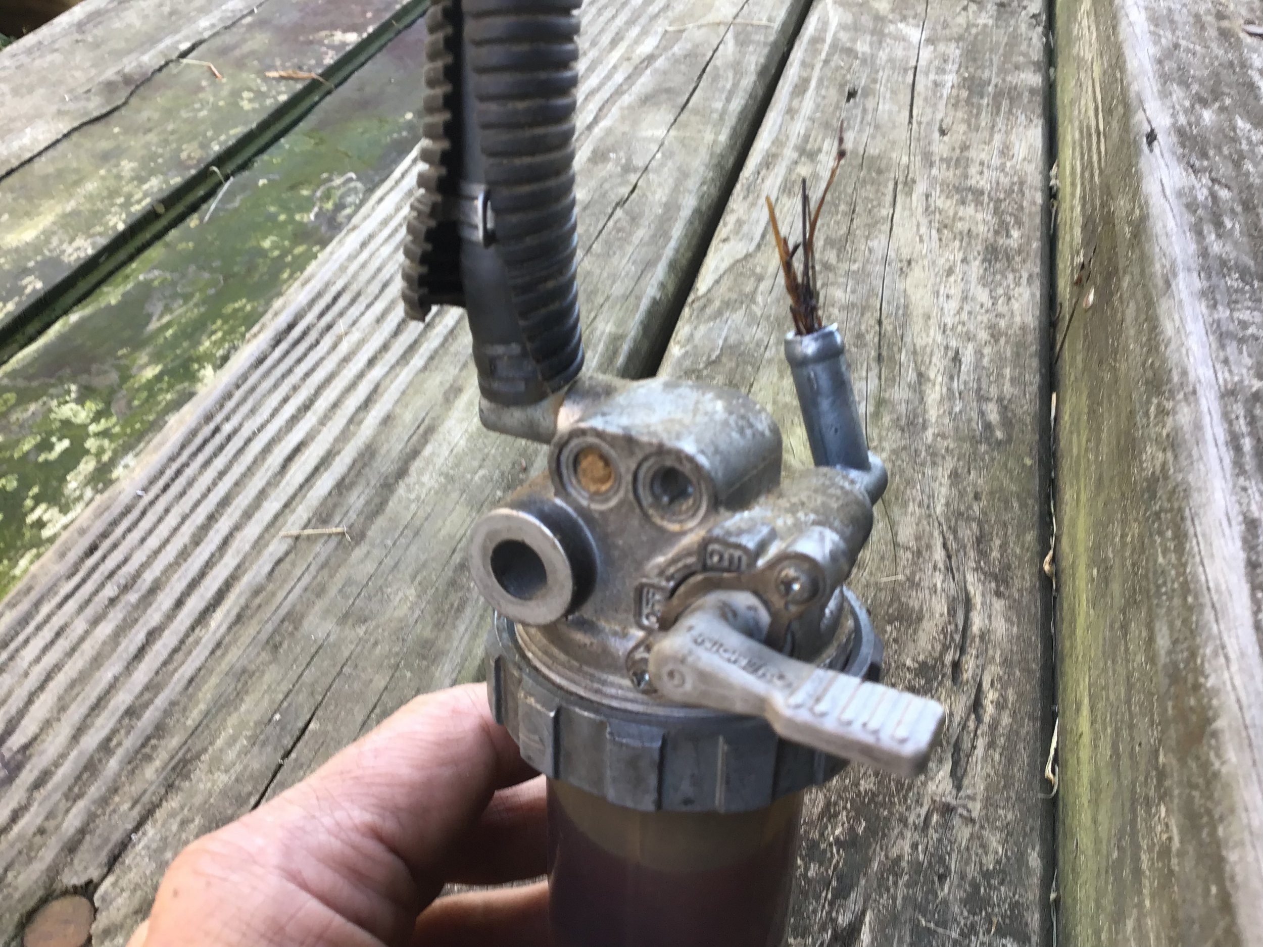

Old thread here... but still has traction in my book. Was having problems with my 08 m9540 and came across this thread. It solved my problem, so thank you fellas! Here are a couple pictures of the clogged up elbow I found. The clog is pieces of grass it appears. I laid them out on some white paper so you can see what can build up over time. My tractor has 2,500 hours on it. I bought it with 1,800 hours and I don't know if this was the first time the elbow had gotten clogged or not.

That is interesting debris to have in the fuel tank. Small sticks or pine needles? Maybe the previous owner did not take care to keep foreign material out when fueling.
