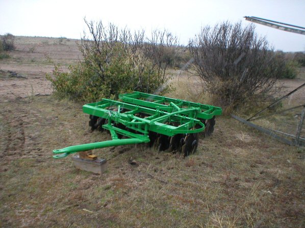

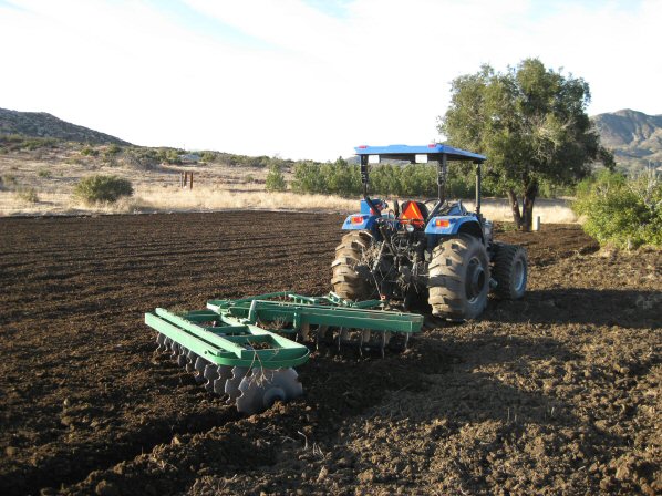

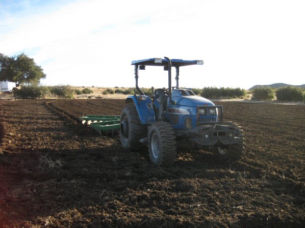

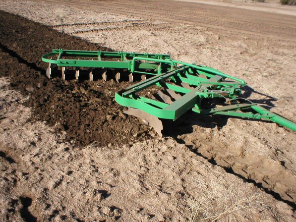

Just my :2cents: here. You do not need more power, you need to have 4 wheel drive and some weight and you will be fine. I have a (75hp) Mahindra 7520 4X4 ballasted to a little under 11,000lbs without the loader. I can pull my John Deere 8' offset disk with 22" blades no problem and I have R4s, not the R1 AG tires. I have pulled it with the axles buried on occasion. I have hills that I disk, so I pull my disk between 5-7 mph. If money is a concern, then look for a 75-80 hp 4X4 tractor that you can get ballasted up to 10,000lbs. ;)
