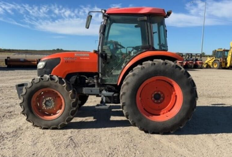

2007 M9540 with rear cast centers, standard fronts per the following:
420 / 85 R 34 Rear Rubber
320 / 85 R 24 Front Rubber
Has anyone else swapped to R14's on existing Wheels on the 9540?
Does anyone know or possibly have ordered a new set from Kubota with the cast weighted rears with R14 or only after?
Anyone know where or have a thought on where to find another set of cast rear centers same size? I still need my AG setup, & I have found the outer rims used, but I might simply keep 2 sets (1 R14 & 1 AG) to just swap as needed.
Anyways, appreciate any guidance. Maybe have to get normal rear wheels + R14 & then add weights. I may look to find a shop that can make the cast centers from what I have now if the price is right & then buy a set of used outers.

Thanks although I am being told the stock Wheels I have wont take the R14s & would require another set of wheels regardless.
Whether these wheels can accept the R14 is really the 1st question which will lead me to either to all new or not.
The tire ballast is going to be added on all the rears even if 2 sets & since I purchased this tractor from Auction, I want to re-mount the AG tires & check 2 of the wheels that may be leaking but not sure yet.
I can if required for new wheels just add the weights. So if holds true needing new, then I need to find out which wheel for my model needed for the R14 & of course a supplier.
Thanks again

Update:
I currently have the Rear 34 \ Front 24 per below along with the Titan Wheels. The R14T Part#s Titan confirmed fit this setup.
I am now looking for another full set of 34\24 to have 2 full sets but 1 AG, 1 R14T in case anyone comes across these, please do PM me & thanks in advance.
420 / 85 R34 Rear Rubber | Wheel = Titan 34XDWW 15A 3 18 07 S2 _ 04 21273 00 187 | R14T = Part# R4T154
320 / 85 R24 Front Rubber | Wheel = Titan 24XW10 129 _ 03 10 8 03 06 S1 | R14T = Part# R4T214GEF
