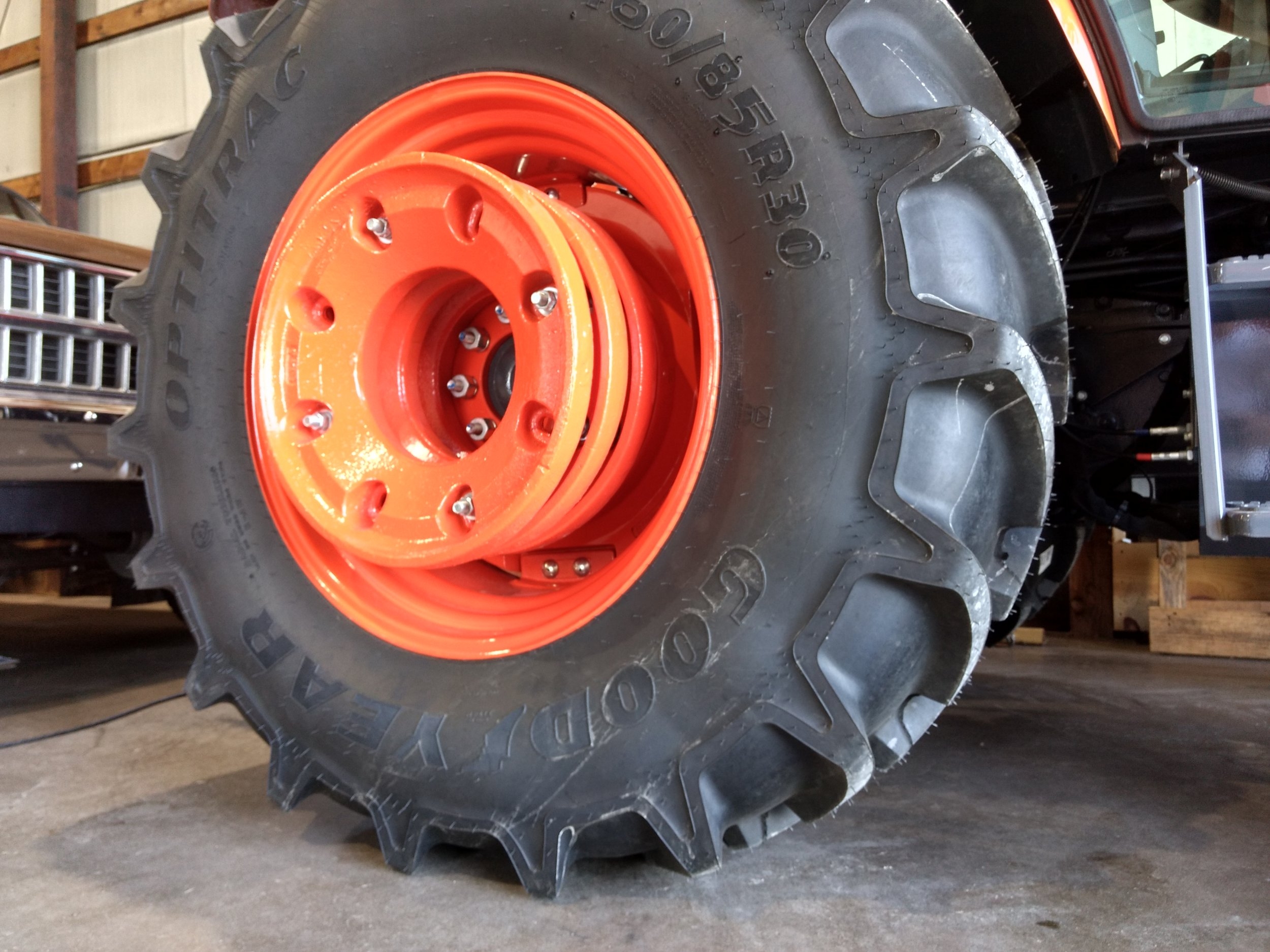

   / Kubota M6060 Cast Iron Rear Wheel Question #25
Hey, I have been negotiating with a dealer on a used M6060 they have on their used lot. Good shape and deal is almost done. But it has the cast iron rear wheels with radials. I do not know the exact size radials at the moment, but here is my question, The outer rim is mounted to the inside of the cast center ( I will try to post a picture ). The dealer dosent seem to want to swap them to where the outer rim is mounted to the outside of the inner cast rim. I would like it done that way, because of thinking future possible flat repair. If the outer rim is mounted to the outside of the cast rim, I figure that if i had a flat, I could just jack the tractor up, remove outer rim bolts and remove the tire and aouter rim and take it to get fixed. This way i do not have to deal with the weight of the cast iron rim and just leave it on the tractor. The added 4 inches on each side of width is another bonus for my hillsides. Anybody have the cast iron rear wheels mounted this way? is it the right way? like I say dealer really dosen't seem to want to do it, thanks
this is how they are now. all i want them to do is mount outer rim to outside of the cast center instead of inside like this......
Just wondering if the only reason you want them mounted that way if in case of needing to remove them for repair? Will the changing the tire spacing affect the use of the tractor say in row crop use or trailer it will fit on. Mine are setup that way and I want to pull them back in for trailering it. You do have the option of loading the tractor and hauling it to the shop which I have done and also used repair truck to the same tractor. Just depends on the situation.
   / Kubota M6060 Cast Iron Rear Wheel Question #26
I agree with you completely on this, however to be clear and not get in a ny type of dealer bashing here the tractor i am buying is a 2021 model with 270hrs....so not exactly new just new to me!
They are willing to do it, but they want to charge 250 bucks or 2 hrs shop time to do it....thats 125 an hour shop time....💲💲💲
OK, that makes it a bit more understandable.
Thats not a terrible price.
Get the tractor set up like you want and you’ll be happier, but don’t worry about tire removal for repair, they repair them on the tractor.
