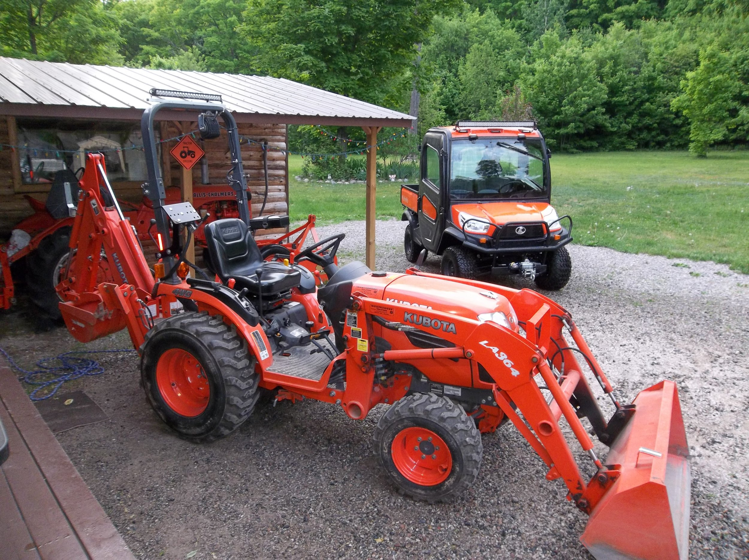

Here's only pic I can find showing part of one of mine. It's just 2x4 stud walls, simple single slope roof made with 2x4's, strapped with one inch then the metal roofing. I never measured inside width, but it is 16 foot lumber on roof and it's 26 feet long. Then just used scrap cedar slabs for siding. Was nice and cheap to build. Then added another lean to on it to display my Allis. All of it just sitting on cement patio slabs.
Been through a few Canadian winters where we get 13.5 feet annual snow fall, no issues.
I also use a sea can for another tractor. It works well too.

Thanks for the ideas. I hadn’t even thought about a container. Paystar, I like the look of the cedar logs on your shed.

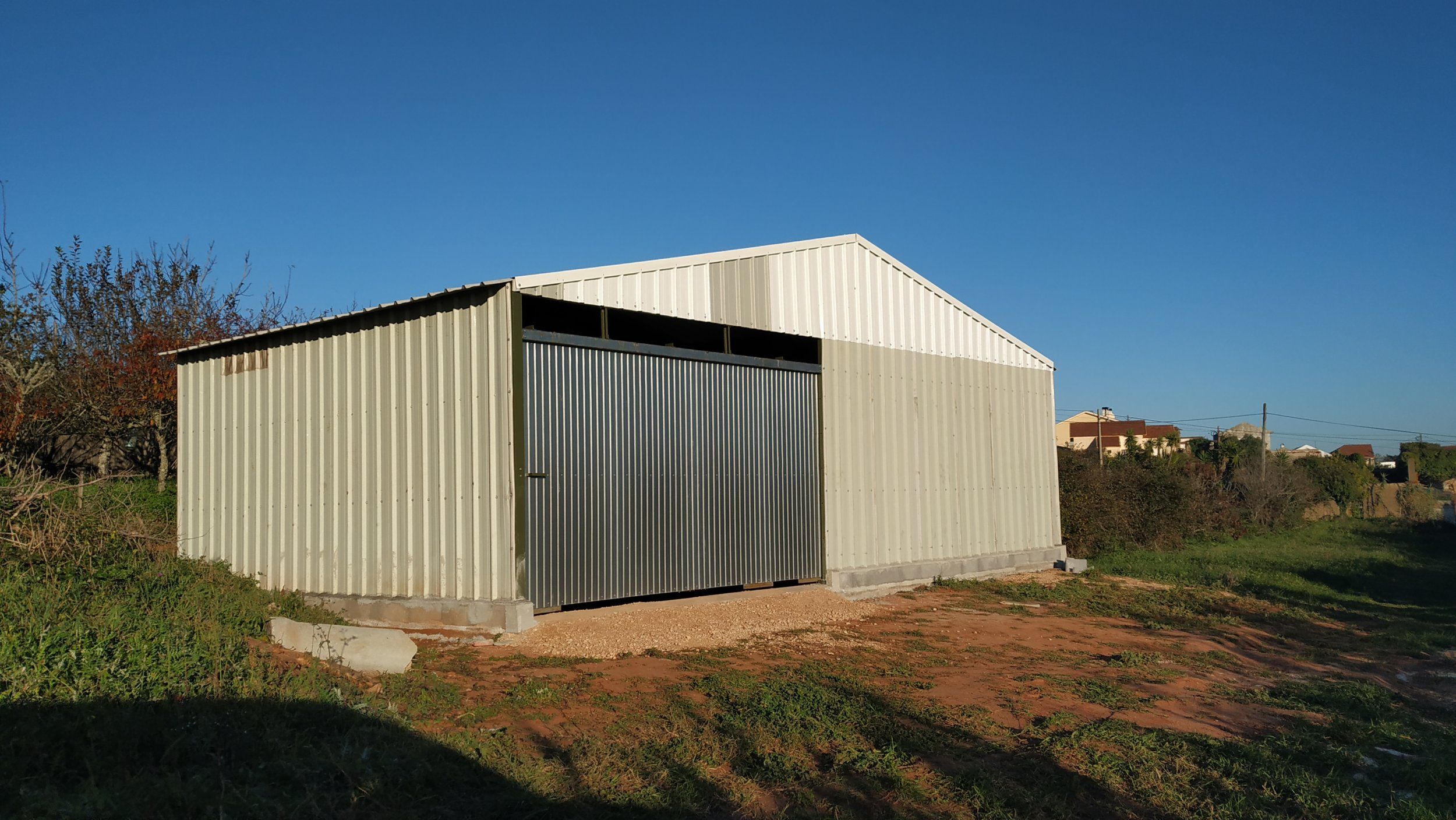

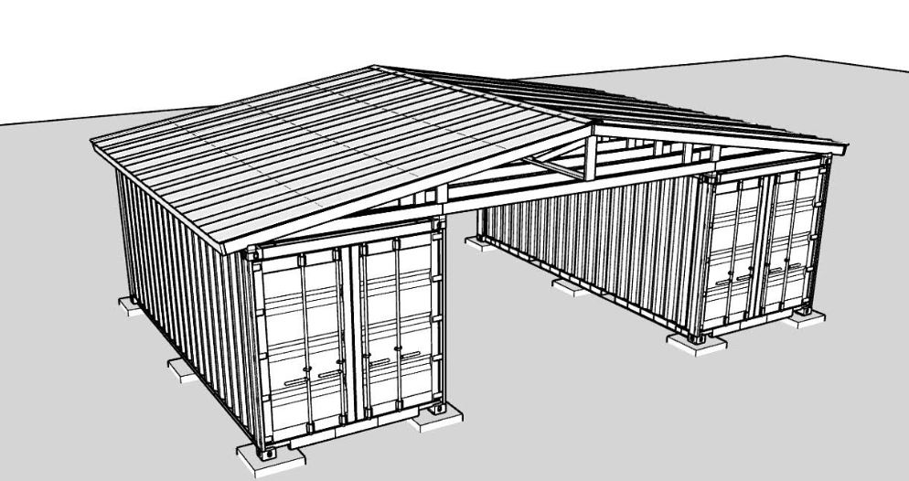

I was in the same situation back in 2021 and I was going to use two 20 ft containers spread about 20 ft apart and then put a roof on it. Eventually I would enclose the entire thing.
I started pricing used containers and they were asking €1500 for a single 20 ft container, so I decided to play with the idea of making a metal building from scratch. Long story short, after finding some good deals on used materials, I managed to build a nice metal building out of mostly used materials with a lot more usable space for less than it would've cost me for just two containers, let alone a roof or sides to enclose them.
I built in my home propriety and then took everything apart and hauled it to the remote propriety about 45 miles North. It still needs painting and the open spots above the door has been since closed with clear panels.
