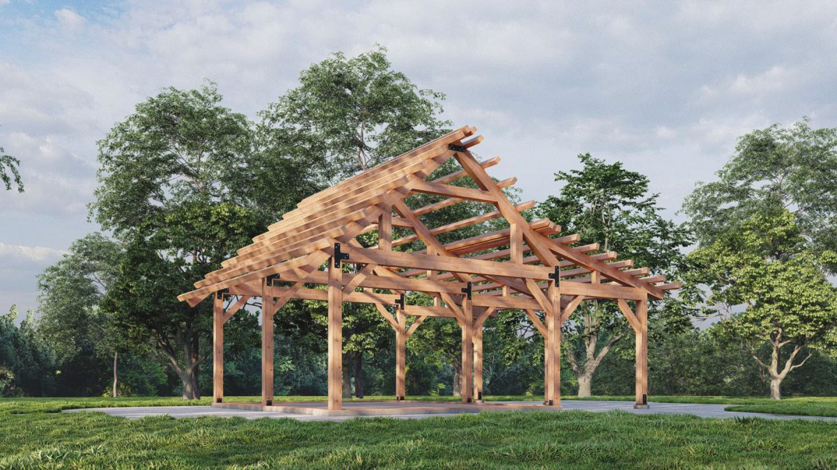

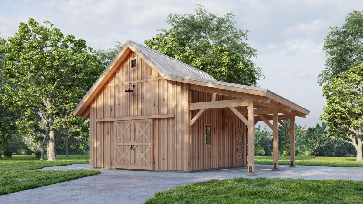

I want to build this. Very simple design.
