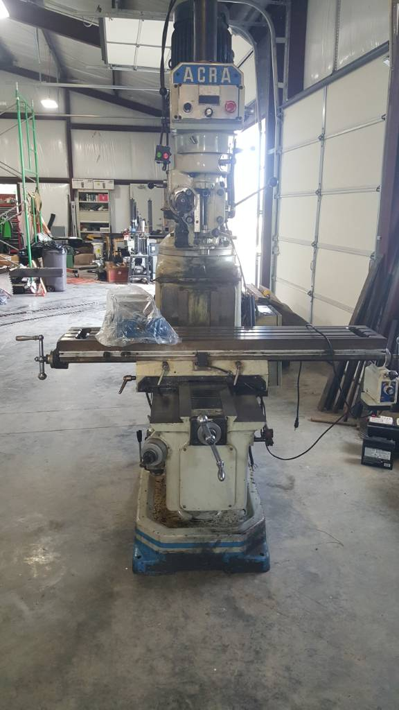

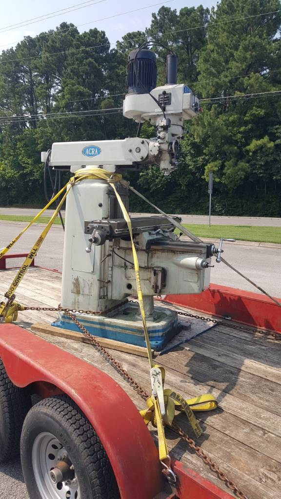

Yeah, my ACRA mill is 3400 lbs. Stiffness and vibration damping are key to accurate machining. The small square column mills can be improved by filling with epoxy granite.

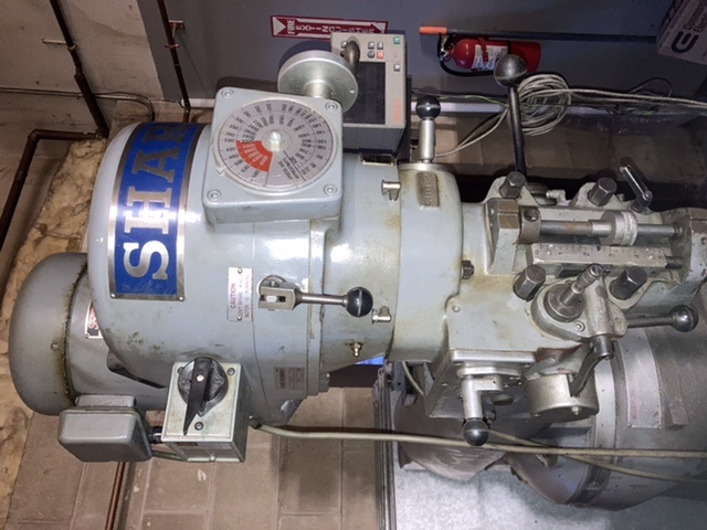

I have used a simple idler 3 phase motor to run my 1hp J head Bridgeport.
Never did anymore than give it a twist of the wrist with one hand and plug in the cord with the other.
This setup has worked with zero issues since the mid 1980’s and took about 10 minutes to set up…

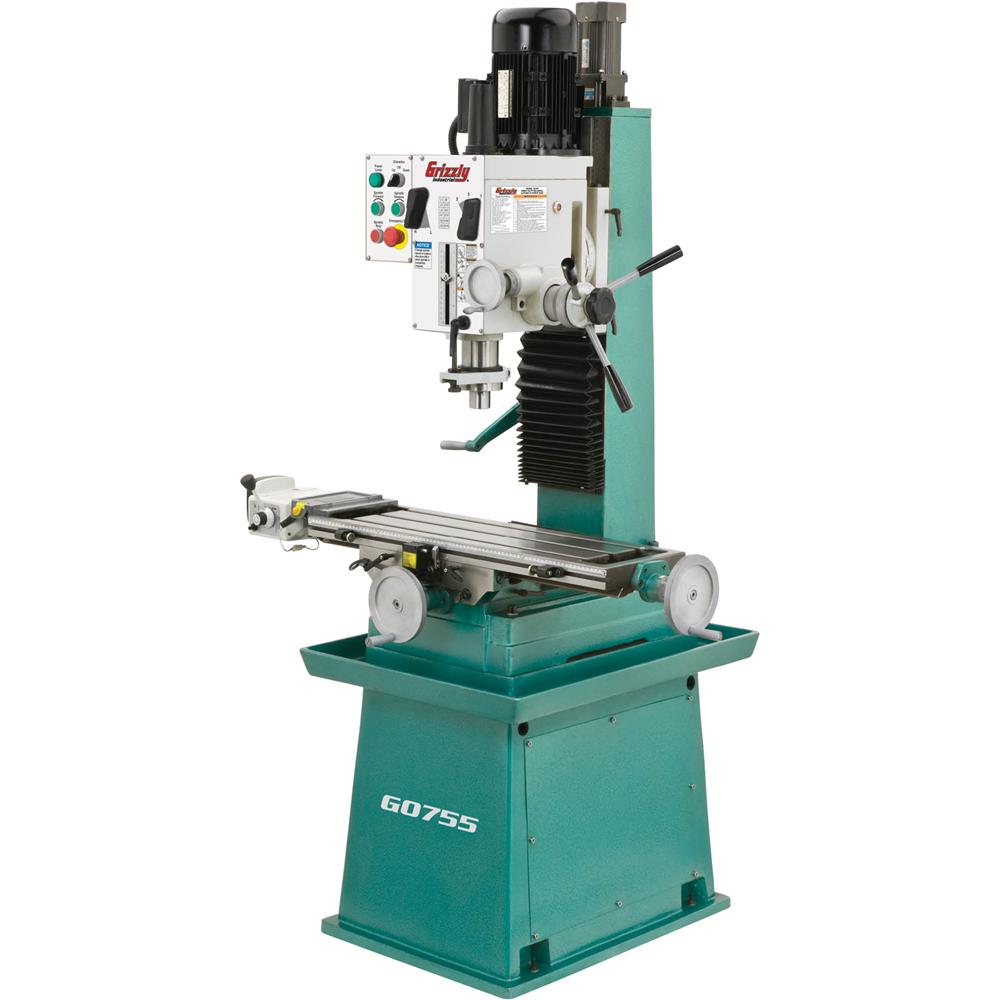

Avoid the round column mill-drill like the plague. Been there, much frustration, no T shirt. Now have a Grizz square column bench top unit, big enough for most needs.
