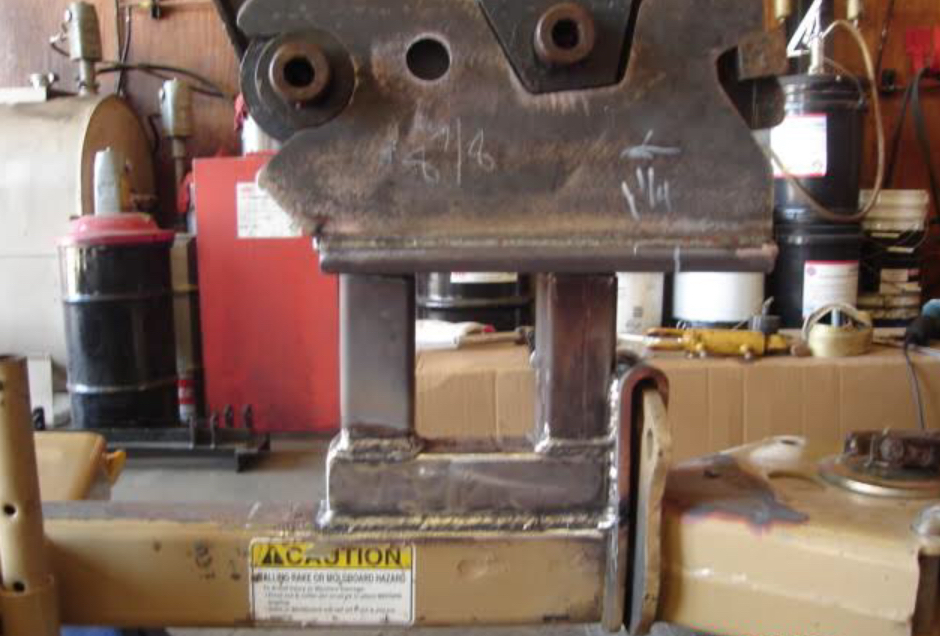

As this is the welding forum, the pantograph I built is one of the more handy projects I have made. Saves hours of time.
Wrap your head around milling something like this out, without a CNC. Now think about shaping it from plastic sheet then duplicating it in steel, one after another, using the torch or plasma you already have.
Other than boring and turning lathes can also thread ID as well as OD and you don’t always have to single point.
Drilling and tapping can be done on drill presses as well, some are made just for the job and in today’s CNC world can be picked up for scrap prices.
That said, none of the above can replace a good mill, the machines complement one another.
