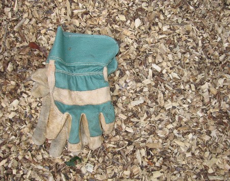

   / Mackissic PTO Chipper/shredder review
#19
Second picture is of the chips themselves.
Cliff

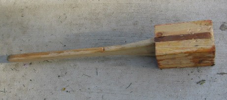

#20
Last one is of the push stick I made to get that last bit of wood down the chippers throat. It's about 18" long. 2X4's attached to a 1X4 shaped for a handle. A self feeding chipper wouldn't have this problem.
Cliff
