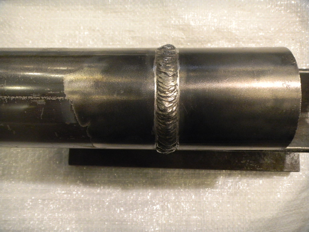

Here's a 2 inch pipe welded in the 5-G position, see how I had to dress the toes of the weld with a file?

Now that you say it, I don't remember 6010 flux being that thick either. Maybe it was a case of right rod in wrong box. Hmmm...
