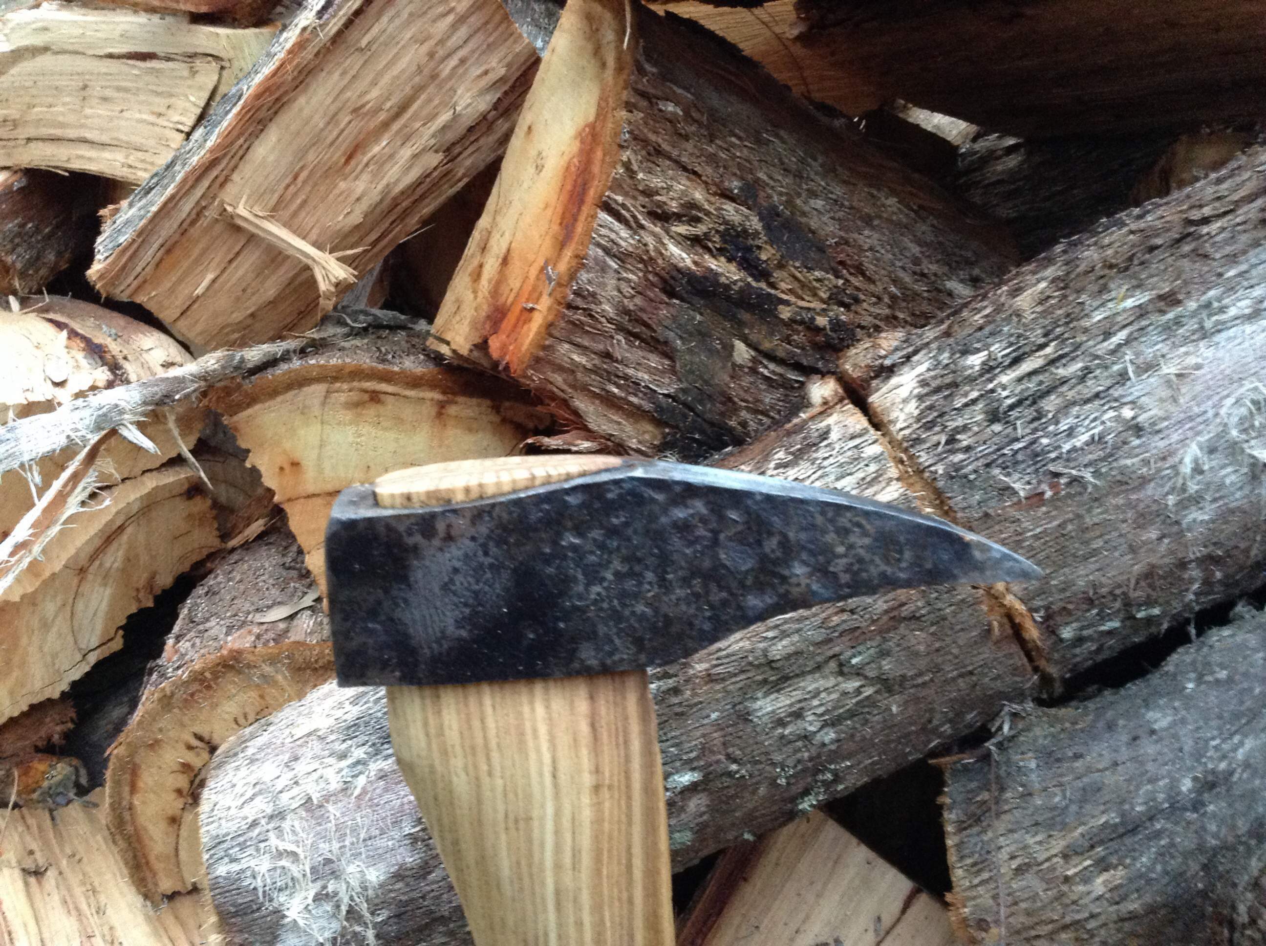

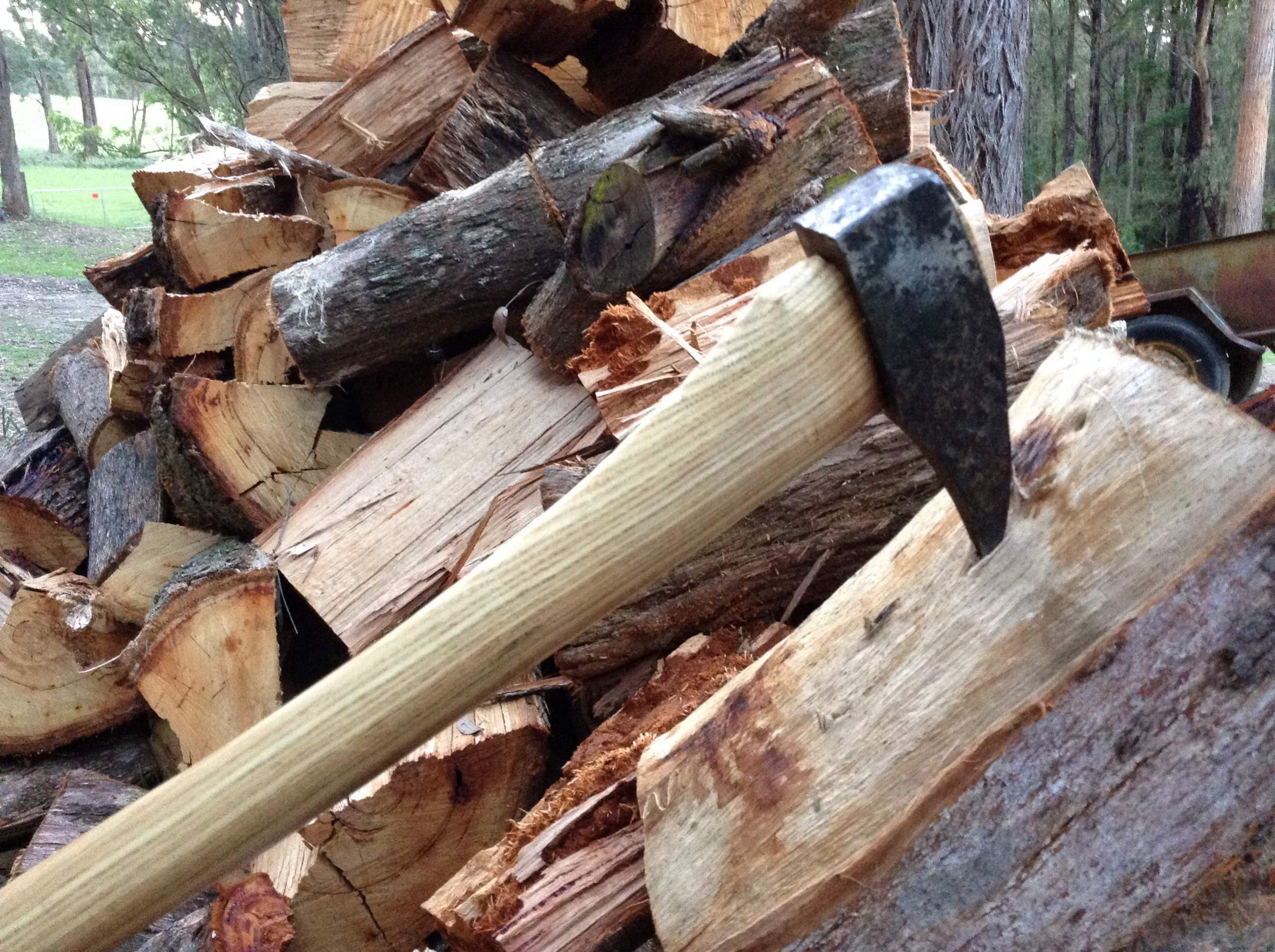

I've seen a few Pickaroon/hookaroons on the Internet and thought I'd make one out of an old axe. After a bit of cutting and grinding I think it came up ok. I was really impressed with how well it works. It really does save your back and makes for extra reach on the wood pile.

Yeah the Utube video of the conversion from an axe is the one I based mine off. There are others where you can use a bolt and a piece of pipe. As far a using it's pretty easy, just swinging it into the wood it sticks and then you can lift it or move where you like. I've found it really good for getting would out of the back of the ute and also saving bending over when I'm using the hyd wood splitter. It's just a way of using the tool and not your back.

I am very familiar with these having lived in Maine for a lot of years. You could peen the tip over a bit to form a "hook" and it helps hold the wood in place. I can take a picture of mine if need be. These are wonderful tools.

Thanks six dogs, I did think of having more of a hook to it however I was worried it could break off. It also would have been difficult to cut that shape with a grinder. This one seems to work really well but I am planning to make another with an axe head in better condition. These pickaroons are pretty much in heard of over hear, occasionally I have seen the odd one pop up on ebay but very rarely.

It's been a lot of years but when my bent tip wore a little I think I whacked it with a hammer.
   / Made a Pickaroon #10
And further, a pickeroon with a hook is actually called a hookeroon. Or it was in the woods of Maine.
