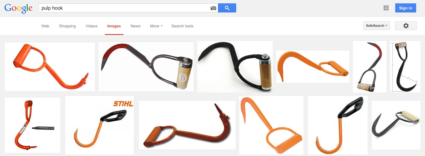

I've seen them, but never used one. I depend on my pulp hook for getting the pieces I want. The tip is blunted with a hammer for better grabbing. Wood does not slip off. Use a torch or forge to heat the tip before peening it- easier.
Tcreeley, could you possibly post a picture of a pulp hook, I've never heard of one before. What dose the peening do, I've heard of that method welding cast iron.

A pulp hook lets you hold a log while moving your hand more to your center line, sort of the power spot. Tried to post a picture but failed -- someone will but also check google images.

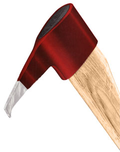

Some of the things labelled hookeroons are actually pickeroons. A hookeroon has a hook to help the log stay on while you twist and pull it into position. A twist of the wrist knocks it off. Here's a modern and exaggerated picture of a hookeroon so you can see what I mean. The hook shown here is actually too big for simple wood handling so maybe it was used for a specific purpose.
