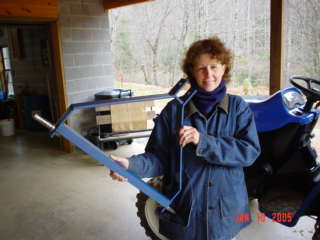

Here is a picture of my little helper.
Sherpa
