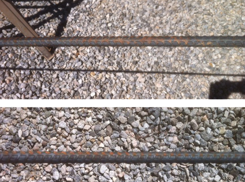

I needed to build some cages for my fruit trees and I remembered that there were still a couple of 20' pieces of #4 rebar left over from my house build 7 years ago. These have been laying on the ground unprotected in the open for the entire 7 years.
Must be some kind of Magic Steel, it doesn't rust.

it may have something to do with your location.... :)

It could be galvanized, but it looks too dark to a galvanized coating. It's possible that it's a painted coating that looks a lot like the original steel. try looking at the cut ends, or cutting a little off the end and exposing it to moisture. If it still doesn't rust, maybe the recycled alloy they used to make it is corrosion resistant, hard to believe it would be some sort of stainless alloy though, as they weed out the more expensive metals when recycling...

Doesn't look like epoxy coated ( thanks JJ for the link) but more likely sprayed with oil or such. Desert conditions are more likely the reason for so little rust. Bring it East and it'll rust for sure.

Likely not oil...after all that's what the concrete guys use to get their forms to release...Wouldn't work well trying to get the concrete to bond to the rebar.

off the wall I know...but is it possible that decaying organic matter (methane) under the bars was displacing/reducing the oxygen around the bars?

It is just the mill scale that is covering it. It resist rust pretty well, but it will rust in wet or salty conditions.

It does look like the gray scale you get when you heat steel to the red/yellow range for forging, although I've never tested it's rust resistance properties, it makes sense since that's just really accellerated corrosion anyway...

It's not coated rebar. I've built over $500 million worth of schools and I'm pretty sure I've seen it a time or 2. The bar was mostly exposed with just a little of blow sand over parts of it. No nearby vegetation. I concur that the mill scale has probably protected it except where the blow sand has sand blasted it off. Lots of wind out here.
Of course, with only 0.77" of rain last year, there is not much to get rust started. Strangely enough, there is a third length from the same build that is completely rusted. It was laying in an area of high clay content which may have held more moisture.
