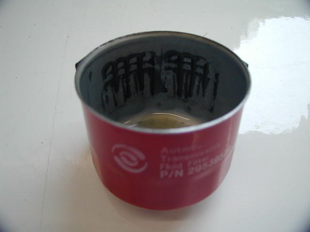

   / Magnet Pre-filters Myth or Fact? #15
Here's a pic of the sludge inside my Allison filter. This one also had the ring magnet on the outside of the end plate. The magnet has been moved around a bunch making the patterns goofy, but you get the idea....

   / Magnet Pre-filters Myth or Fact? #16
I am with you Soundguy, Catch all the devris you can even if it is not all. Many Automatic transmissions have magnets in the pan to catch ferrous metals.
