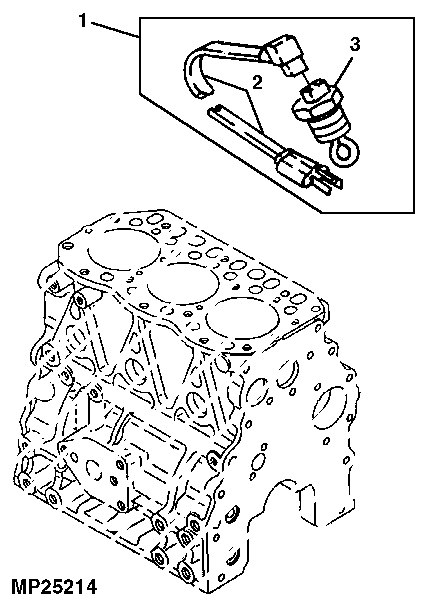

I'm thinking of getting one of these magnetic block heaters for my 4300 and putting it on the oil pan for some heating. It says it heats to 300-400 deg. would this be OK? Does anyone have any experience with these.

Why not get the block heater from JD that's designed for your tractor?
