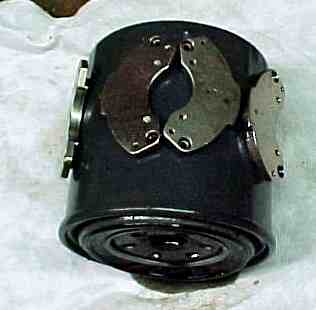

I had two extra magnets for a Chalkley cup and it was getting close to the 50 hour oil change, so I stuck them on the outside of the filter. After several days I changed the oild and filter. I cut the filter with a shears and found black stuff stuck to the inside where the magnets are attached.
I think I'll put them on the new filter and leave them. Of course they will only help with particles too small to be filtered, but that is some help and they will be doing more than sitting on a shelf.
It is simple and easy. Some of you might like this idea.

I've done this for the past 10 years or so on all our cars and it's on my tractor too - you'd be surprised at what gets collected in there. I also put a magnet on the oil pan right by the drain plug (or use a magnetic drain plug). As the pan is draining, remove the magnet to flush that crud out of there.
That's a lot of magnets for one filter!

Jim, I emailed your picture to a GM mechanic friend of mine, and, like nick, he also suggested a magnetic drain plug. I don't know if you can buy a magnetic drain plug or if you just put a magnet in a standard plug.

Jim; Good idea.
I like it better than the drain plug because all the crud gets thrown away with the filter. The drian plug relies on the oil flow to push any remaining crud out when you remove the plug.
How could this cause a problem? All the magnets are on the outside right? So the worst thing I could see is that the magnets fall off and get eaten by the brush hog.
