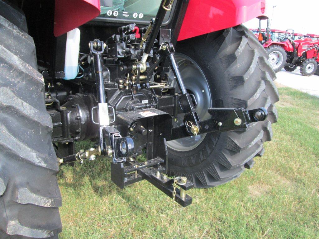

That's some good info Dave. I saw the claw design on the Tym and thought it was pretty neat with the ball inserts or quick link option. I do not know what the flex link is like on the Mahindra. Could you explain how it works? Thanks for your input.
   / Mahindra 100 hp tractor #46
The flex link is just a name for the typical extendable lower links, just like many tractors use today. This flex is especially nice on larger tractors with heavier implements, since it can be tough to manhandle a big heavy implement. Mahindra spec'd out the tractor that way on purpose. The claws are cool, and if they work with your implement then there isn't much of a downside other than occasionally losing a ball if you aren't careful. But the claw will occasionally not work on implements. If you have an implement with a clevis style hook-up that is in a shallow pocket or if the pin hole is just a little close to the implement, the claw will not work. It is just a little bulky in some cases. The 4510 and 7010 cabs we sold a few years back had the claws. I had to cut off the claws and weld on standard spherical links more than once. Sometimes you can modify the implement, other times you have to modify the links. But on the standard flex links, you hardly ever get into a fitment issue. I'm not saying it happens all the time, but it does happen.

Thanks for clearing the flex link up for me.
