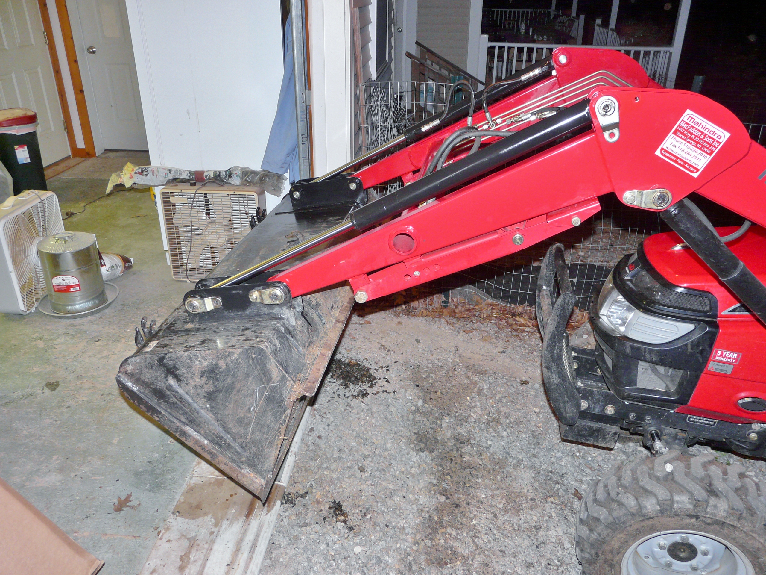

   / Mahindra 1526 Limp Front bucket #7
If you read your FEL owners manual you will notice that back dragging at more than a 15 degree down angle is prohibited as there are no port reliefs in the FEL hydraulic circuit and you will damage the cylinders.
I welded a scraper L Angle on the back edge of my buckets to back drag. Plus some 1/4" thick side Plates to the bucket edge.
Back dragging still beats up the loader, but with a lot less leverage than the front cutting edge.
That doesn't look like a bad idea! I might look into doing something like that, thanks
