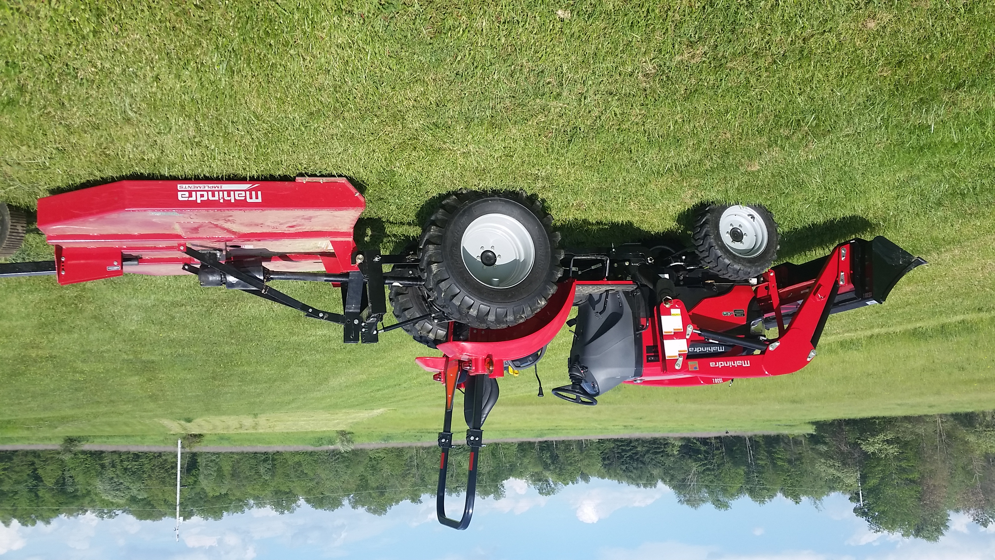

Brian thanks you've solved a problem and the width is perfect again I'll post a picture but it's pretty dirty I'll take a lead from you and clean mine up!

My just happens to be less than a year old and I did bump my wife's car out of the garage so that I could deter theft which happens to keep it clean looking. Now she says we should build a barn, hmm sounds like a good idea.
I originally was looking at the Max26, but wanted something just a bit bigger. Then they came out with the 1526, which I considered, but the PTO power was less than the that of the Max...not by much, but I couldn't wrap my head around that scenario, I was concerned about PTO. So I was all set to buy the Max26 and my wife had another grand idea, she told me that as soon as I got it home, I'd regret that I didn't have something bigger ...so ... I bought the 1533 and since has respectable PTO, I had an idea to go for the six foot because I knew it would handle it... Which, as stated earlier, it does.
