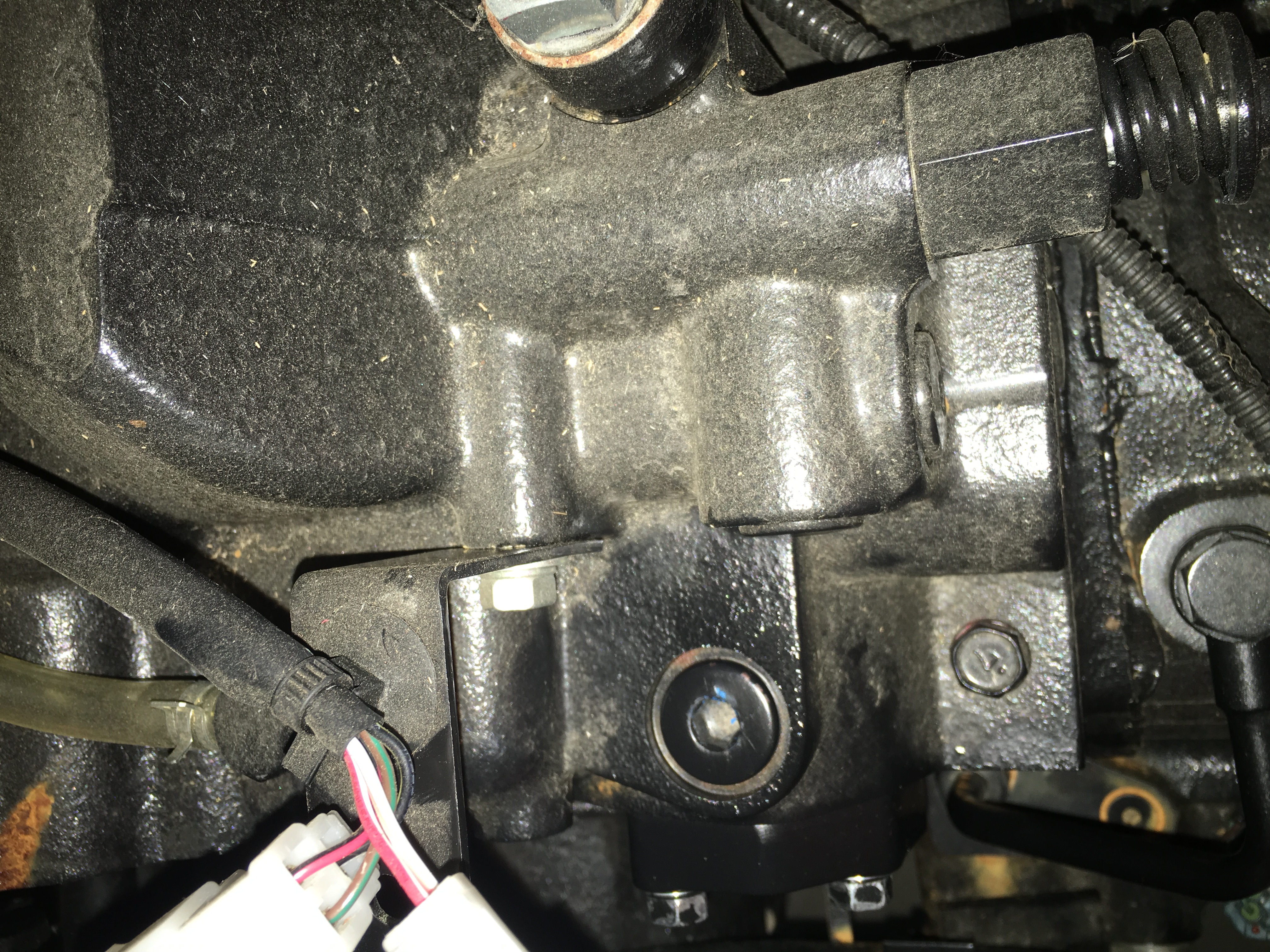

Thanks RNeumann! I'll take the seat off this Saturday and take a look. I'm curious whether you installed the remote from a kit or did you piece it together like I'm am doing? One thing I have determined is that all of the hydraulic fittings on the tractor itself are of the JIS variety so I'll be adapting over to more readily available JIC type.
   / Mahindra 1538 hydraulics question #12
It was pieced together. I found several different style fittings on the machine- o ring, pipe etc. Once you figure out the fitting coming out of the loader control and the one going into the top of the case you should be able to run everything with the fittings you want.
#13
IMG_1389.JPGRNeumann I attached a photo of the ports under the seat. There's 3 of them. I assume one of these is what you connected your drain to tank into. Is that correct and if so which one? Thanks.
