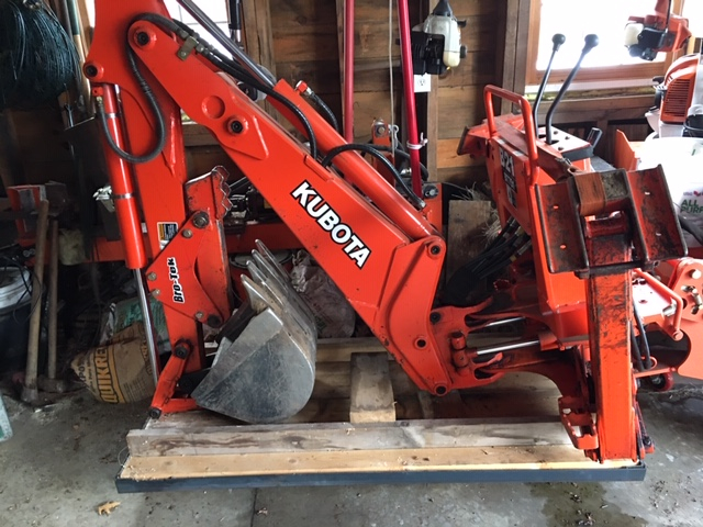

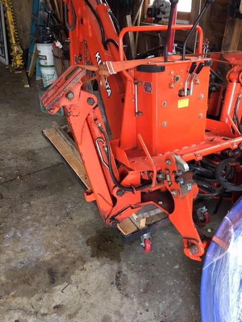

I put mine on a dolly and roll it away to the side of the barn - takes up 3'x6' - then on reinstall roll back into position and hook up the lines and its back on quickly. It weighs ~ 700Lbs but easy to roll on the dolly. Takes 10 min or so and the 3PT arms are another 5 min to R&R.
I put it on in the spring and take it off in the winter for the SB or back blade.
