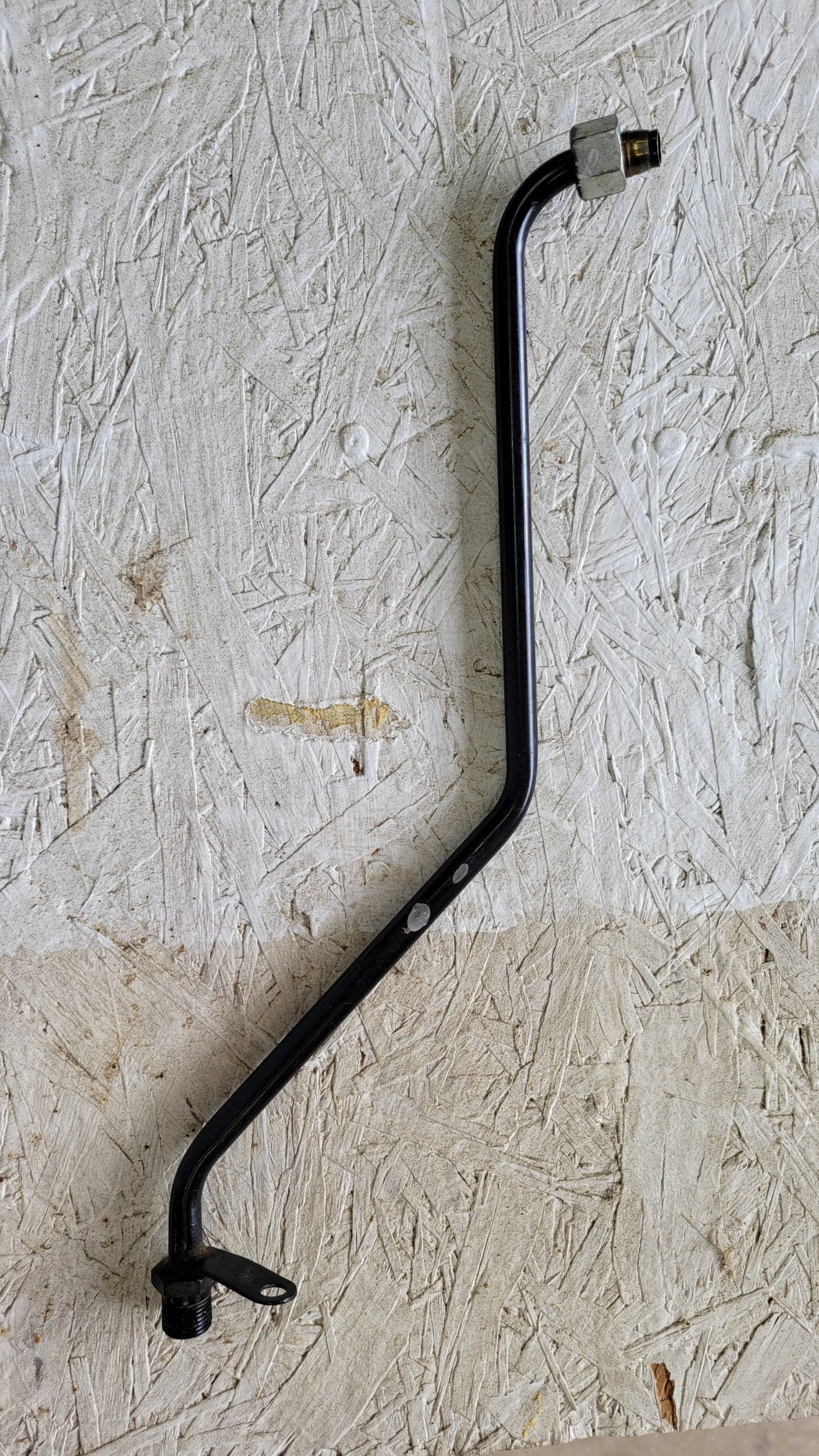

Had a leak start today while spreading gravel with 325 hours on the meter. The power steering hoses have couplings about halfway between the steering valve and cylinder and for all this time they (the couplings) were rubbing on the steel line going from the pump to the main pressure relief valve; today it finally gave way. I took the steel line to the local hydraulic shop and had a hose made for $44. Just thought I would make everyone with a similar tractor aware of a possible issue.
