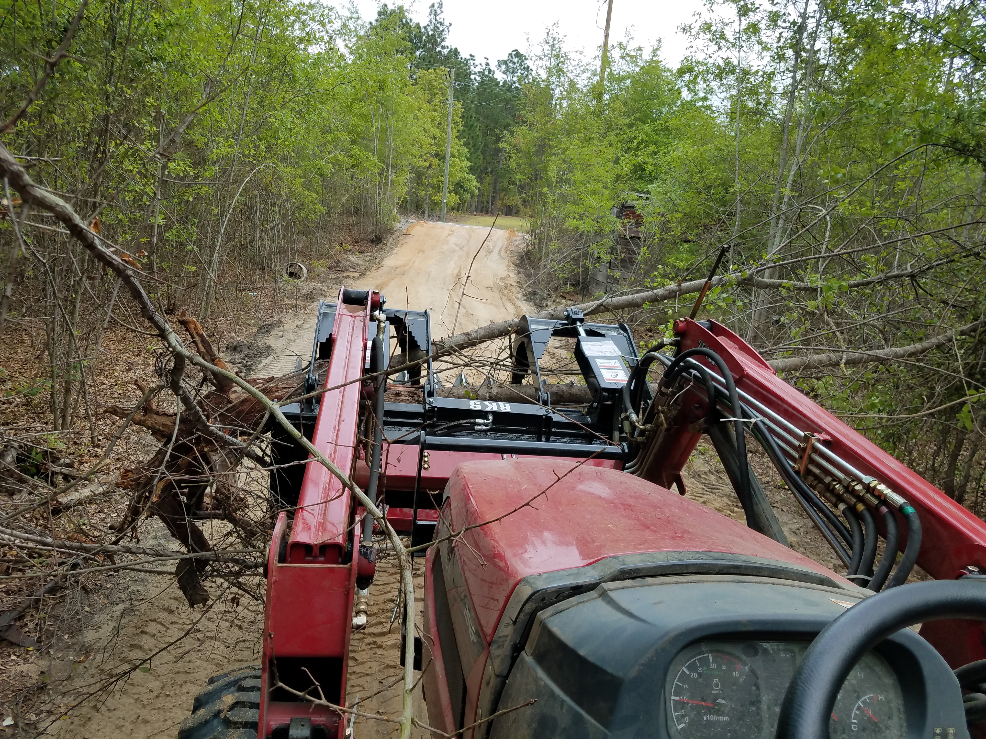

Looks good nice job putting it all together. Do you thing the threaded coupling will solve the leaking problem?
   / Mahindra 2545 on sand
#192
I finally got some time to figure out what was leaking. It wound up being one of the 1/2" NPT connections at the quick disconnect. I pipe doped it and put the thing in a vise to tighten it initially. Not sure why it was leaking. I swapped the coupling out with another and it sealed up fine. Used the grapple for at least an hour without any leaks.
#193

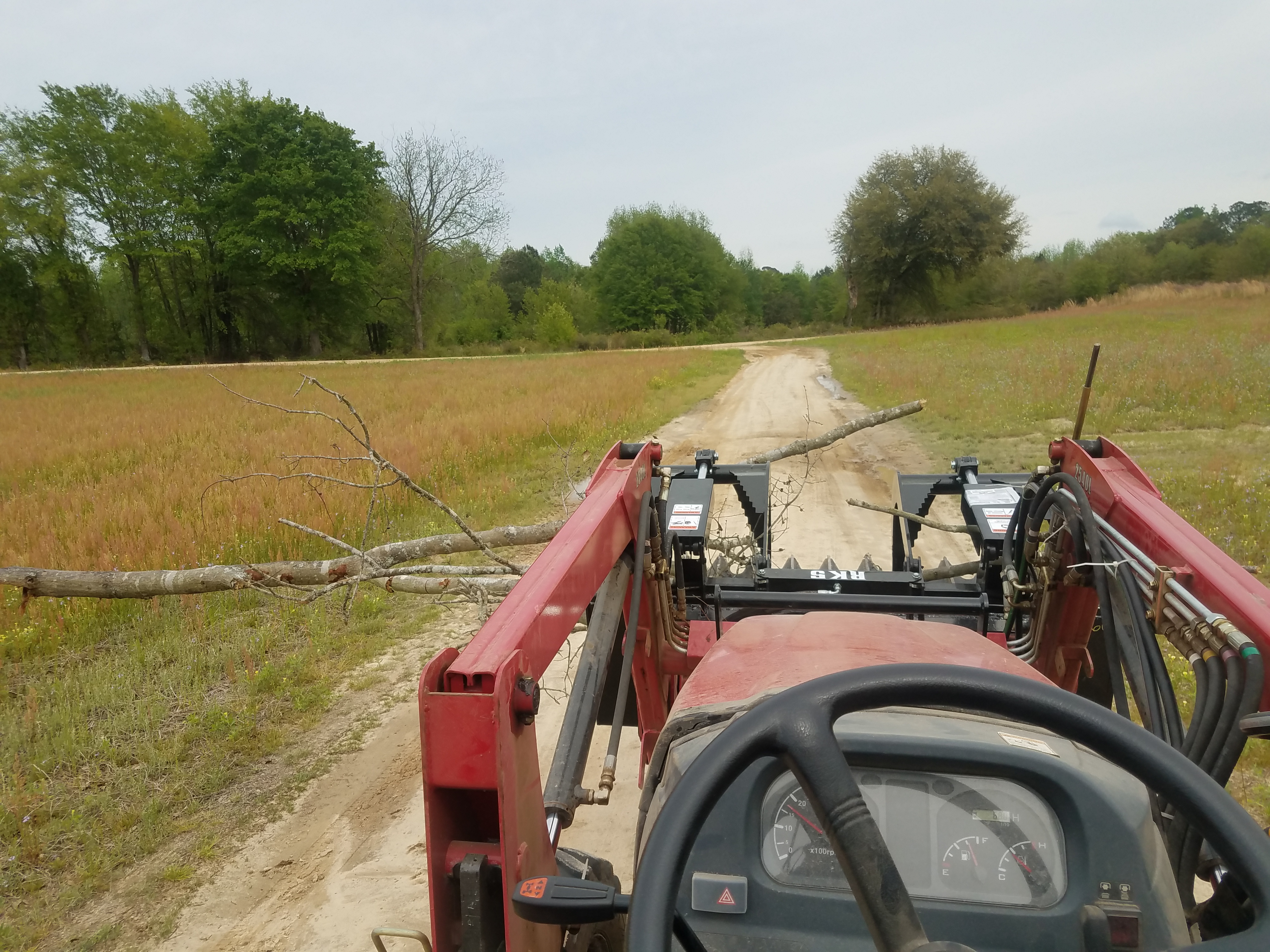

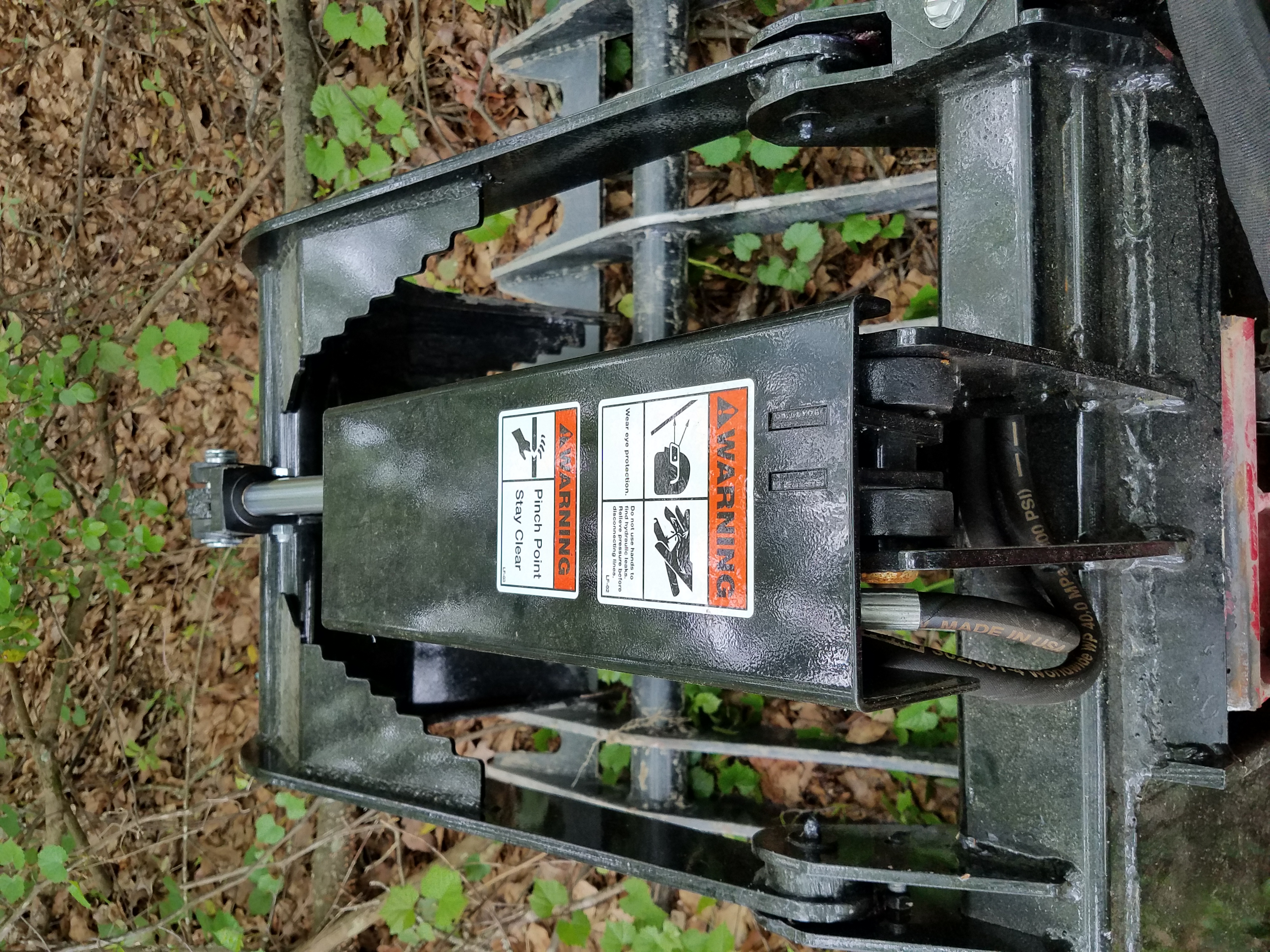

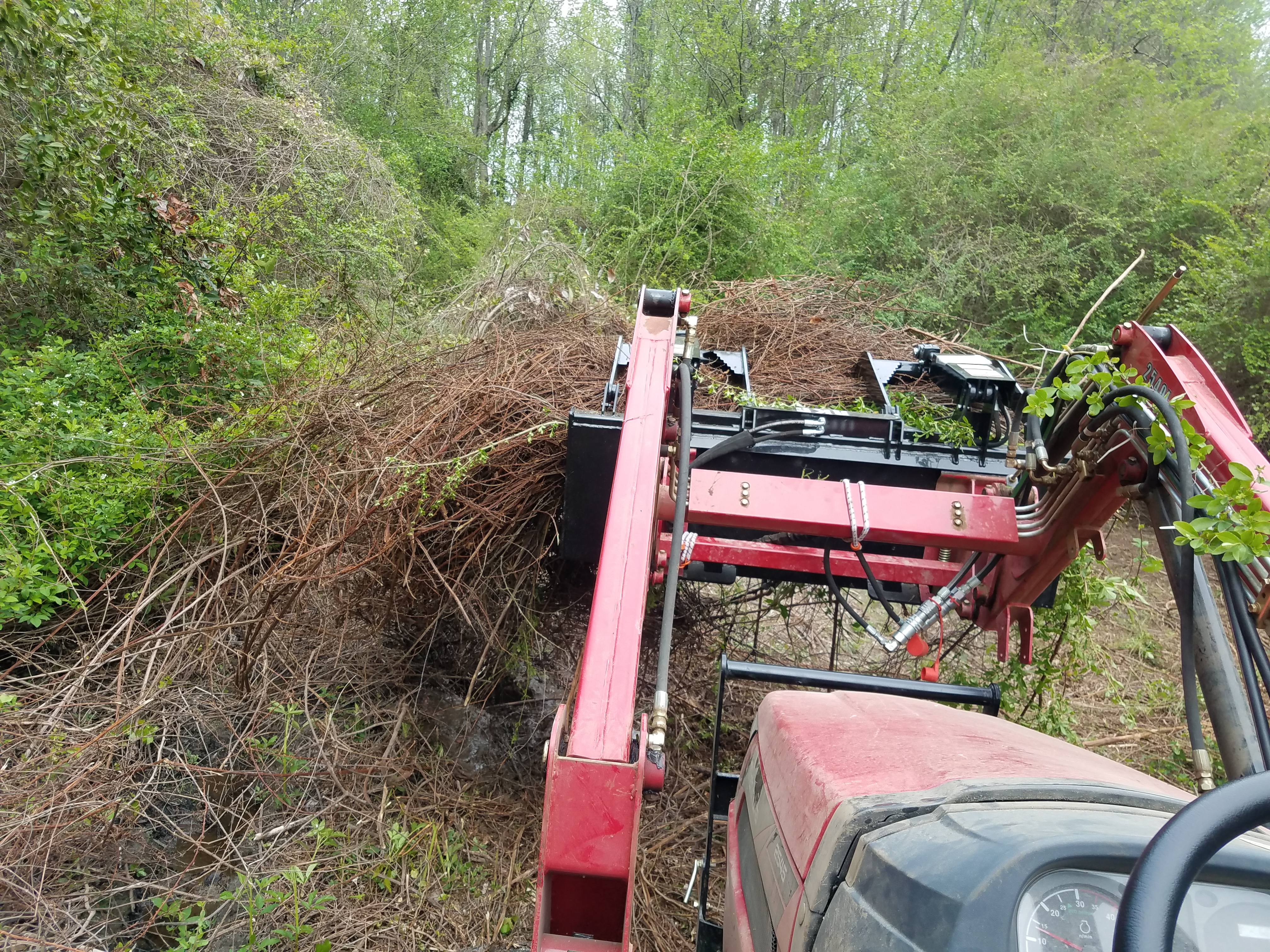

Really enjoying the grapple. The cement truck dumped a big pile of cement that the tractor couldnt lift. I could flip it but I couldn't push it. The cylinders on the claws are strong. I was able to basically drag this huge piece of cement just from friction as there wasnt anything to grab onto. I'll get a pic of the cement pancake at some point. Tractor has over 70 hours. Can't imagine not having it at this point.
Dual grabbers I thought were a gimmick at first but they do have a benefit. I don't understand why only one set of pins are greasable. From the ad, may have been a lack of attention to detail, but I assumed all pins had zerk fittings. Only 4 pins have grease points.
Can't wait to get some more hours on the tractor and pull that hyd filter apart.

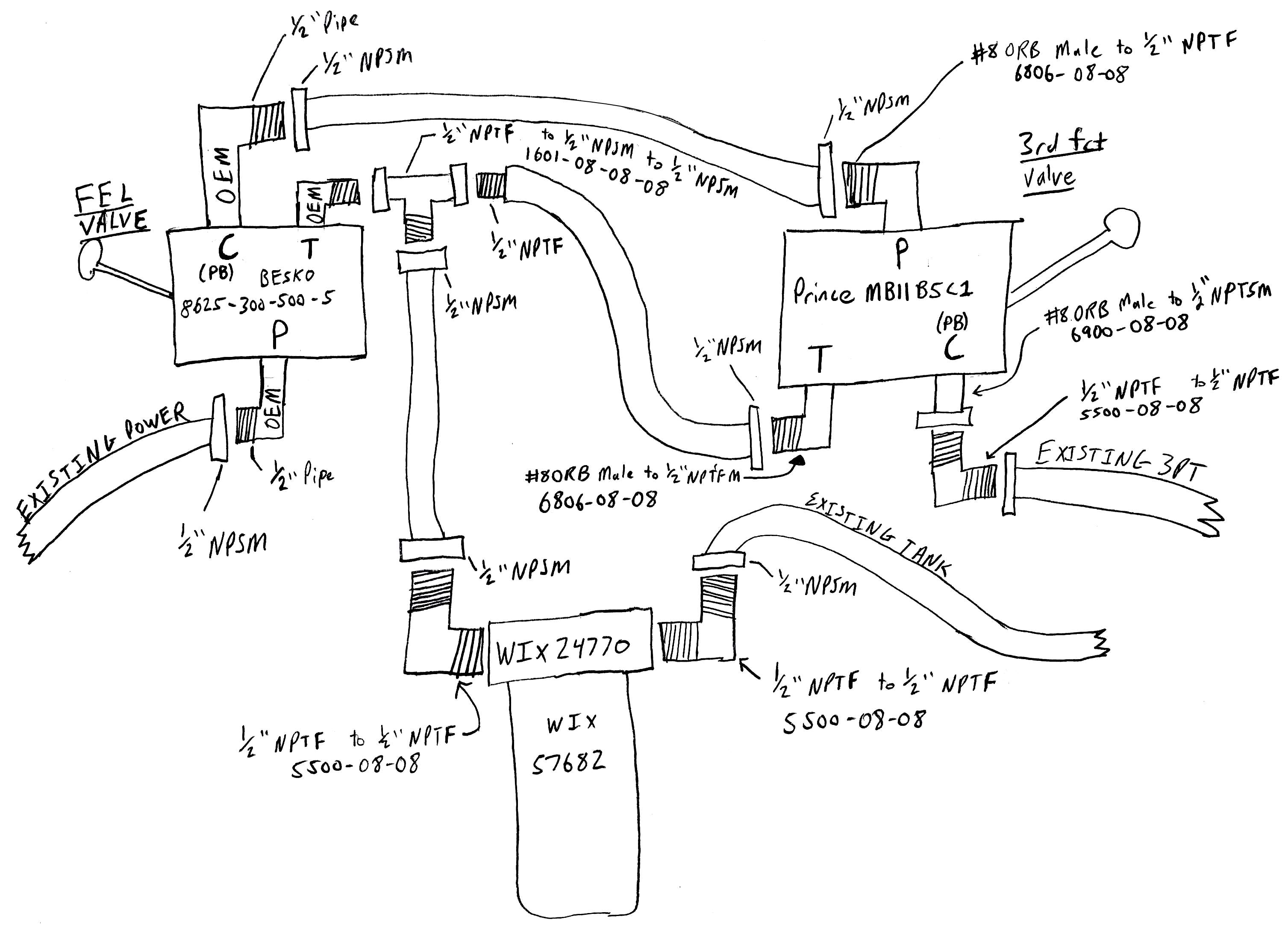

This obviously doesn't include anything from the valve out to the third function implement. Two sets of fittings/hoses are not included (power A and B valve output). But, here is the rest of the project with discounthydraulichose part numbers. Items listed as NPTF are male connectors, NPTSM are female. The two valves are sandwiched together, this is the easiest way I could find to get it on paper so I could visualize what was going on. The port locations are correct relative to the handle of each valve.
I chose to have one hose Male to Female so I can easily take the filter in and out of the loop by connecting the tank line directly to the "T".

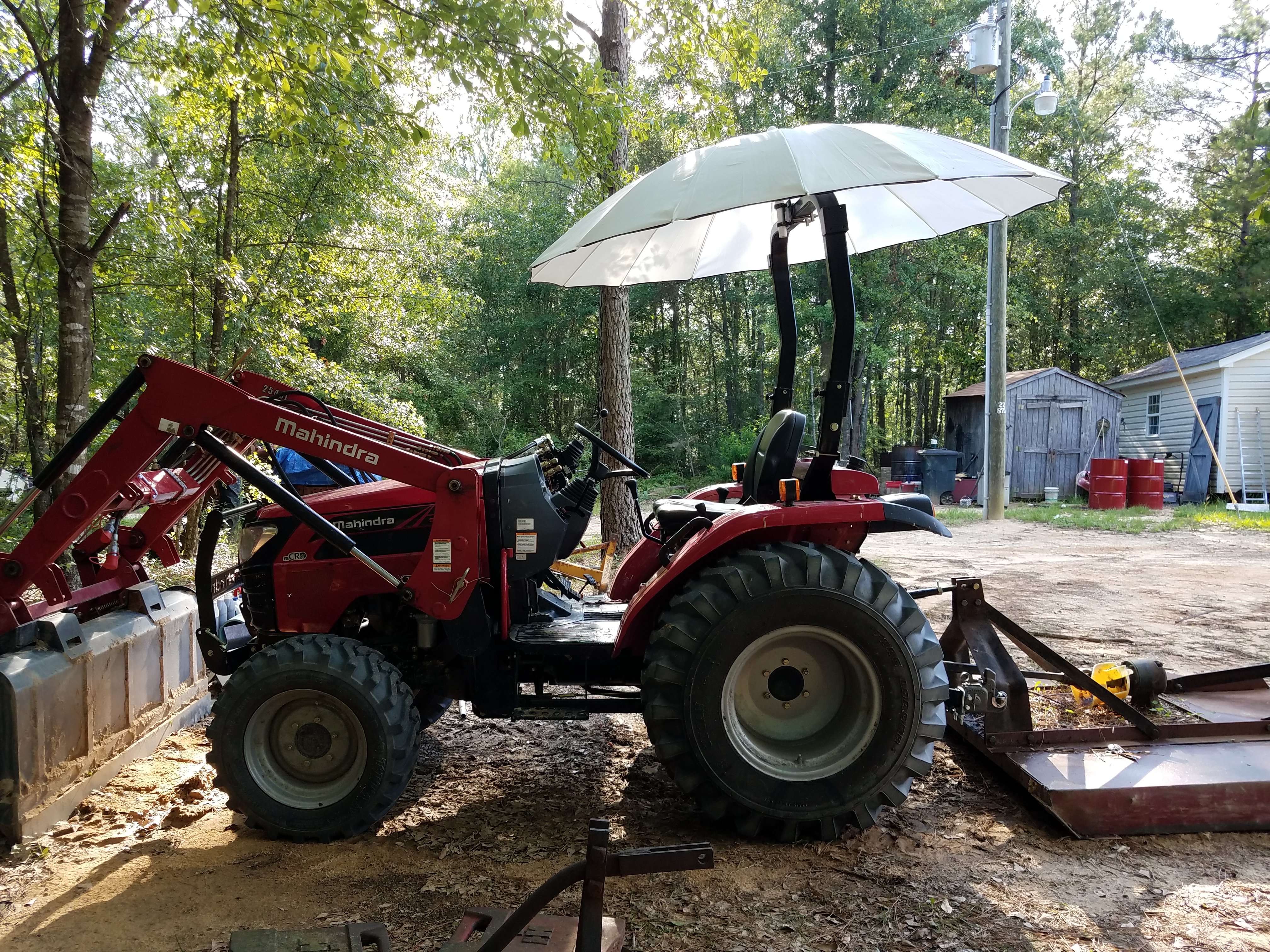

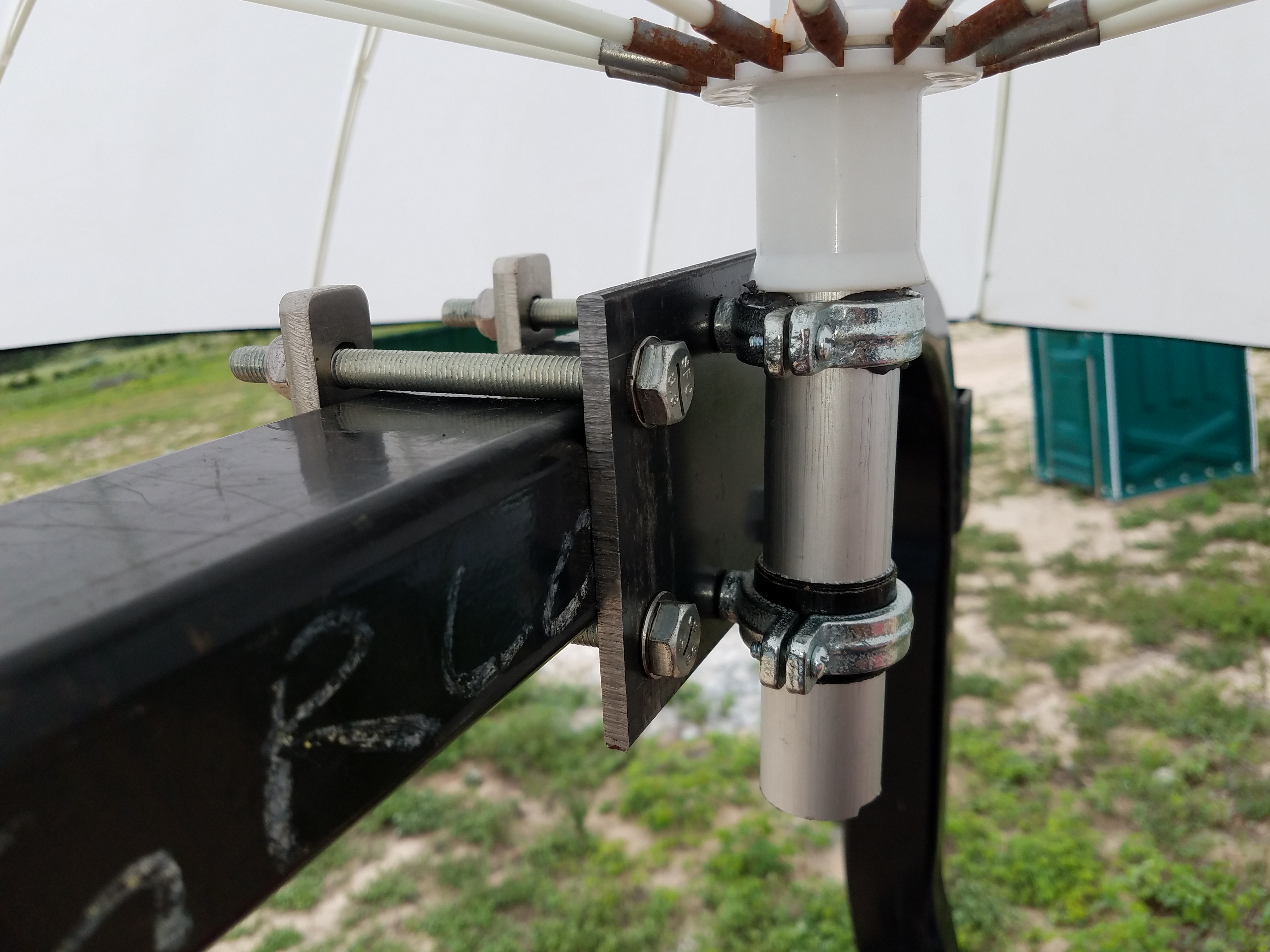

Still havent passed 100hrs. Made an umbrella mount for a beach umbrella. Works great so far..
Need to fix the angle though.
