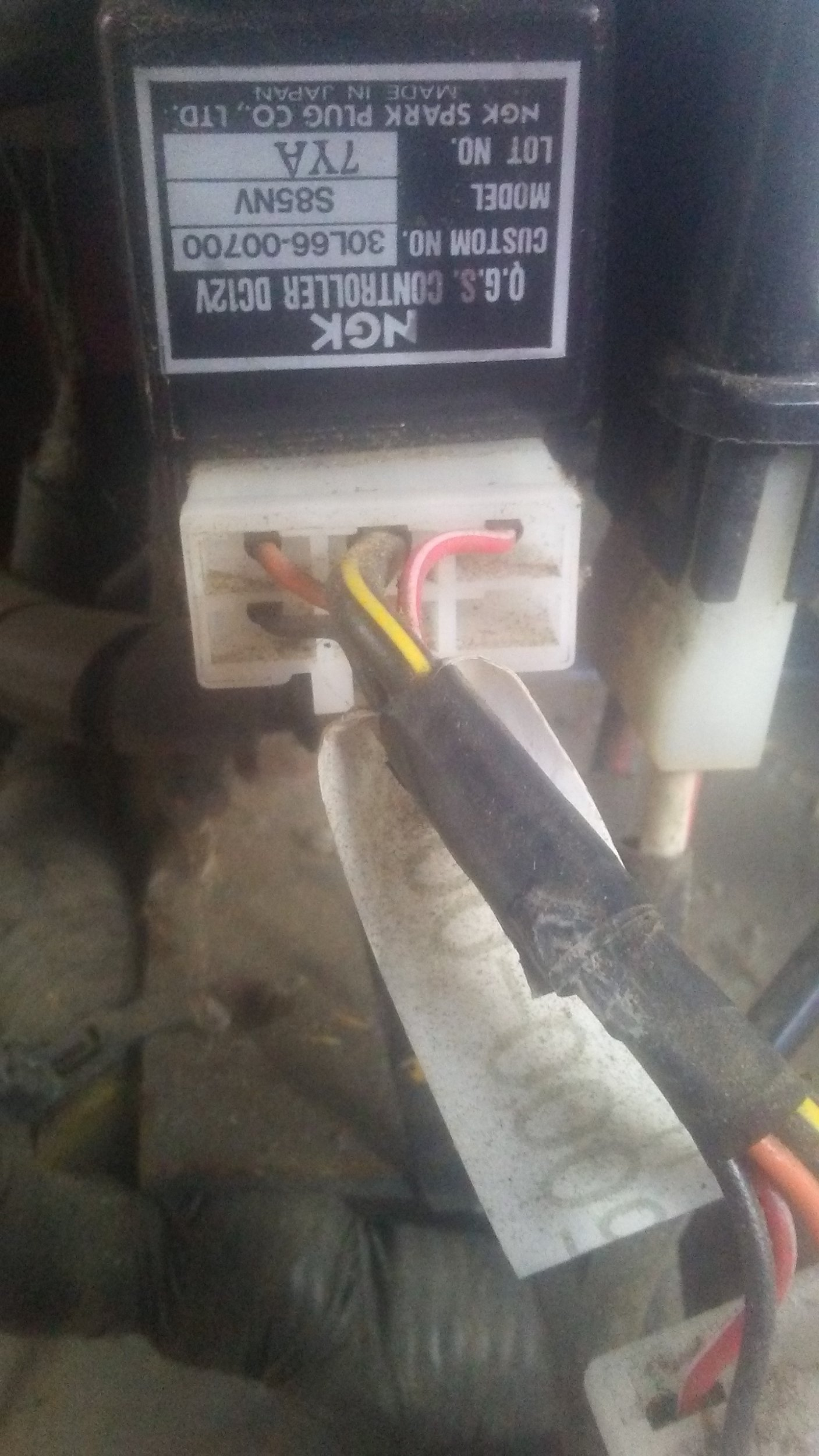

   / Mahindra 2615 Glow plugs #15
Having similar concerns with my 2615hst.
Removed glow relay and bought replacement. However I failed to pay attention to where each plug went!
I have three plug, one will only fit one place, so I’m good there. My confusion is as follows: I am left with two plugs ins that are identical and will fit either of the remaining pins. I can tell which is ‘hot’ using a test light. My question is does it matter which plug goes to which pin? I see no marking on new relay to indicate positive or negative.
I do know that I have power coming into the relay, via a test light.
Thanks for any help.
   / Mahindra 2615 Glow plugs #16
I don't know if this picture helps because your tractor might be a different generation. My replacement timer/relay was plug and play.
   / Mahindra 2615 Glow plugs #17
Thanks for photo, but does not match mine. Mine glow relay is also plug and play.
