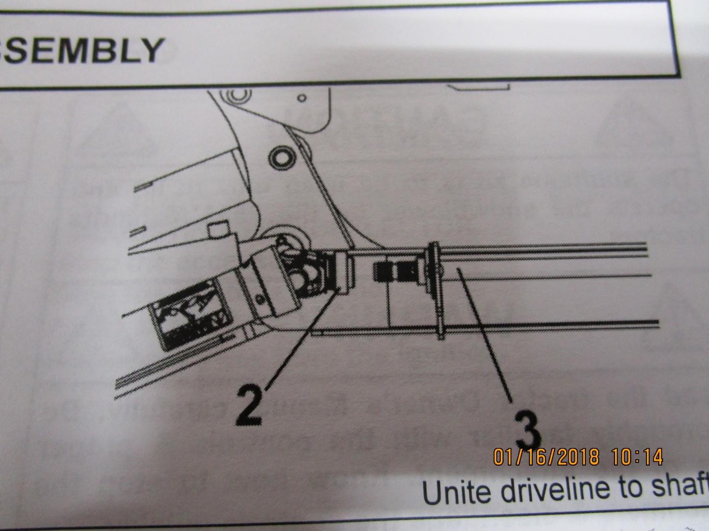

   / Mahindra 3616 blower broken shafts #4
It looks like the front shaft can [ or should ] only be assembled one way, so that should negate a phasing problem. When you get it all back together, see if you can unhook the driveshaft quick connect [ #2 in the second picture ] from the main driveshaft [ # 3 ] and get some forward movement showing that the front shaft has some elbow room and not pressing forward on the gearbox. If so, maybe the main shaft is sticking forward too much. Only other thing I can see is if the access cover that is above the shear bolt area is put on using the wrong bolt holes, and sticking out too far forward keeping the driveshaft from lifting up enough. You might want to check the phasing of the rear shaft going to the MidPTO gearbox. There should be no vibration to speak of, a little noise, but nothing bouncing around.....

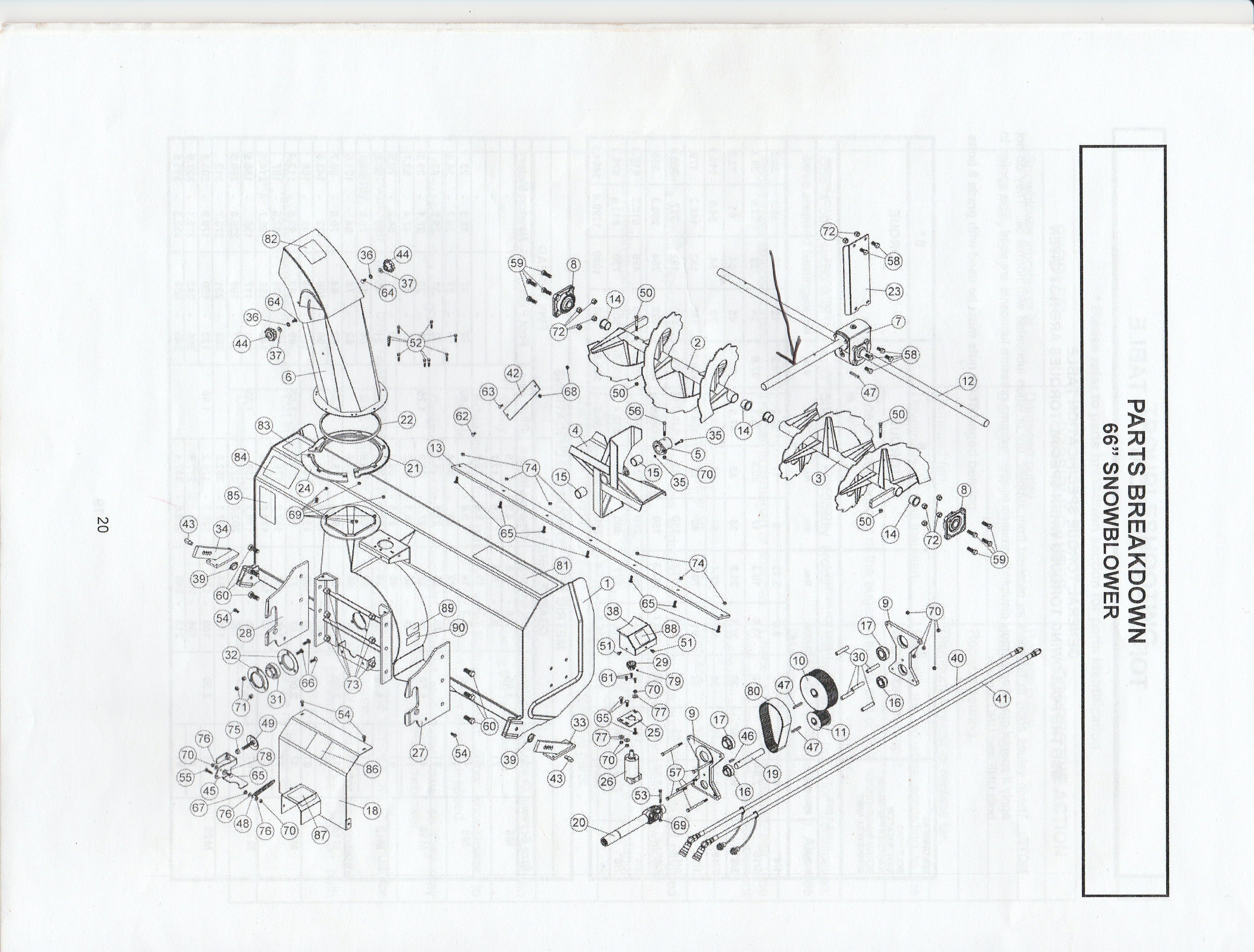

This is my blower, parts breakdown, the shaft that breaks is the shaft with the arrow pointing to it, it breaks inside the gear box.

   / Mahindra 3616 blower broken shafts #6
The shaft is breaking inside the gear box so according to your diagram that is after the impeller so that rules out the impeller being part of the problem. Check how free the auger is rotating. Make sure you don't have bad bearings on the end(s) of the auger and that the auger shaft is straight inline with the gear box. If the ends of the auger shaft are not lined up to the gear box, that could be jamming the gears together inside the gear box.

   / Mahindra 3616 blower broken shafts #10
Ok so I'm going to stick my neck out here a bit. If there is any vibration in the pto shaft it will be absorbed by the belt. I'm assuming the pto drives the bottom pulley.
If I understand the drawing correctly that shaft has the top pulley and the impeller and the gear box on it. There are two bearings one on each side of the pulley plus one where the shaft goes through the blower housing just before the impeller. The two bearings fit into part number 9. I can see where the bottom bolts go that hold the two number 9's together. That would be close to the number 73 on the drawing. Where do the top bolts fasten to?
To me it looks like there is enough going on in this area that there should be a specific order in which to tighten up bolts and bearing collars etc.
I would say make sure there is no binding when part number 23 is tightened up. Or maybe there is some flex happening under load in that area. Also when bearings number 8 are installed the bolts should just fall into place. There should be no prying anything to install them.
If it was me repairing this I would cut and install a flex joint in the shaft that your arrow points to. Something like a LoveJoy coupling would do the job. Or two sprockets back to back with a double roller chain coupling them together. Something to isolate any impeller shaft misalignment from the gear box shaft.
