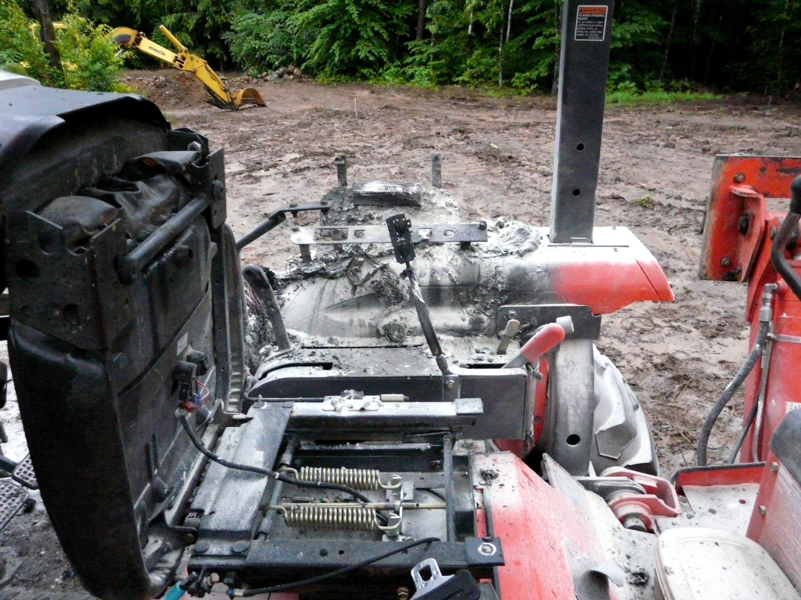

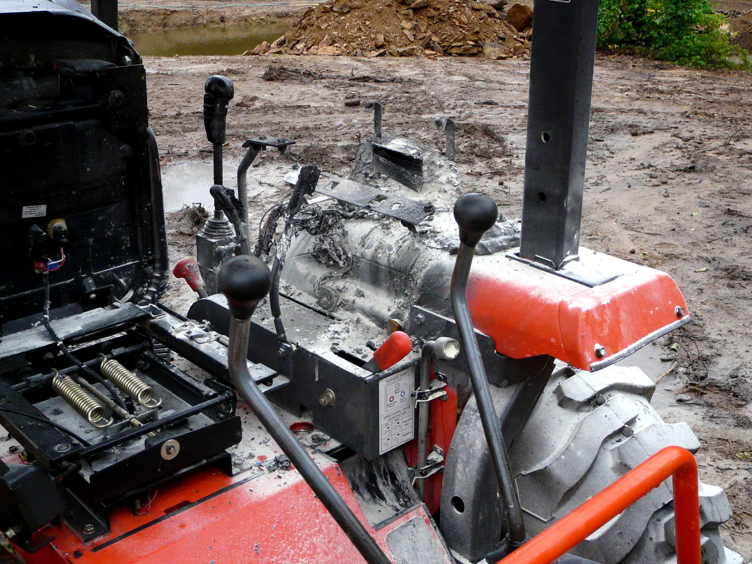

Been there, done that!
Suspect it was a lightening near miss. This caused circuit board to allow battery load to wires, and eventual fire.
We lost garage door opener and some auto-on/off outside light that night too.
Almost $6,000, I had insurance.
If tire had really lite up, bye-bye tractor.
I'm sorry about your situation.

Sorry for taking so long to get back to everyone. First of all I would like to say thank you to everyone for all the great advice and input on the possible cause of the fire and the steps I should take going forward. I took the tractor to the dealer the next day, and they informed me that they had only cut back the wire near the battery and put a new lead on, they let me know that it was nothing they had done that caused the fire. They were nice enough about it, and confirmed that I had installed the rebuilt starter correctly. The service manager thought it would cost roughly $8k and a few months to fix the tractor, he said I would need to leave the tractor with him for a few days for him to do the write up, but I decided to keep it with me. I ended up contacting Mahindra's corporate office and informed them of the situation, they asked me to email them pictures and a write up of what had occurred. They are sending out a regional/national service rep next week to come look at the tractor, and try to figure out what started the fire. So far Mahindra's response has been great, and I am hopeful that the situation will be taken care, and that the service rep will be able to tell me what caused the fire to happen. As soon as I know anything I will update the board and post some pictures of the damage. Thank you all again.

Just want to say my 4035 caught fire last week as well. 10/11/15. The fire started on the wire that was for a remote electric hook-up by the pto. Smelled it burning and shut off the tractor; fire continued up the wires to below steering column and fuel tank. In a panic I was able to put it out with dirt. I disconnected the battery once I got the fire out; but not before it fried the central wiring harness and the wires leading to the instrument panel. I may need to buy a new panel, hoping to get out of it for the cost of a new harness. Could there be a manufacture defect that is causing these fires?
